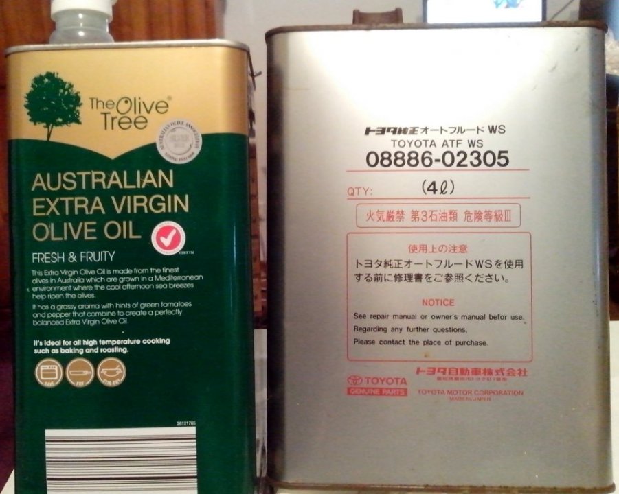

    Every time I despair at the high price (relative to the US) we pay for stuff for here in Australia, along comes someone from New Zealand to make me feel like we're not getting such a bad deal. :p
    BTW Al, that 4L metal container is how the WS is sold here too. I think the last one I bought was about $65 (au), which puts it a about double what they're paying in the US. But wow $150 in NZ, you really have cause to feel ripped off!
    Each time I pick up one of these I joke with the guy at the parts counter that "last time I accidentally cooked my chips in it" (referring to the metal container making it look a bit like cooking oil). :LOL:
    Here's a picture of one (empty) I had laying around. This old one has been sitting around for a few years so it's a bit rusty. Seeing as I like to make the joke, here it is next to the oil that I do actually cook my chips in.
