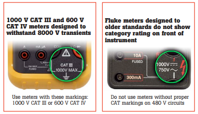

    I have only recently fully grokked that the super-dependable Fluke 87 I've had for 30-ish years, despite being rated for 1,000 volts, is just a hair too old to have an IEC measurement category rating. If I had bought it just a couple years later ...

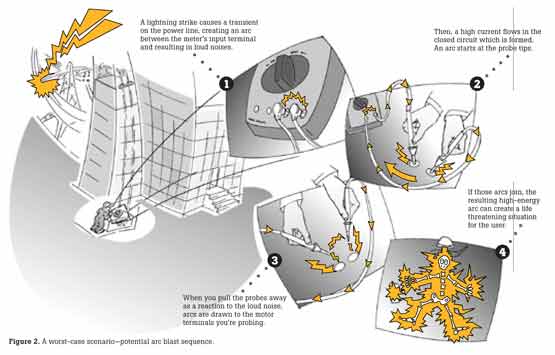

    The measurement categories (I know I'm not explaining them to you, Jerry, but some folks might be interested) were thought up because of a problem that's hard to avoid: even if the voltage you expect to be there is well within the rating of the meter, what happens if there is a voltage transient just as you happen to be taking your measurement?
    It's kind of frustrating, as my old meter works great, but I should probably consider it my spare or low-power electronic meter, and pick up a newer one before poking inside panels.

    Or, in the case of the guy I mentioned, it wasn't a transient. He just forgot that it was 4160 rather than 480 like almost all of our other motors, ignored the warning stickers, and jimmied the safety interlocks. All the other electricians were stunned that he would have made such a dumb mistake, but even the best can have a brain fart. That was a bad one.
    But yeah, I've seen a couple transients. And fixed lots of damage they caused. I would not want to be checking electric voltages during a lightning storm.
