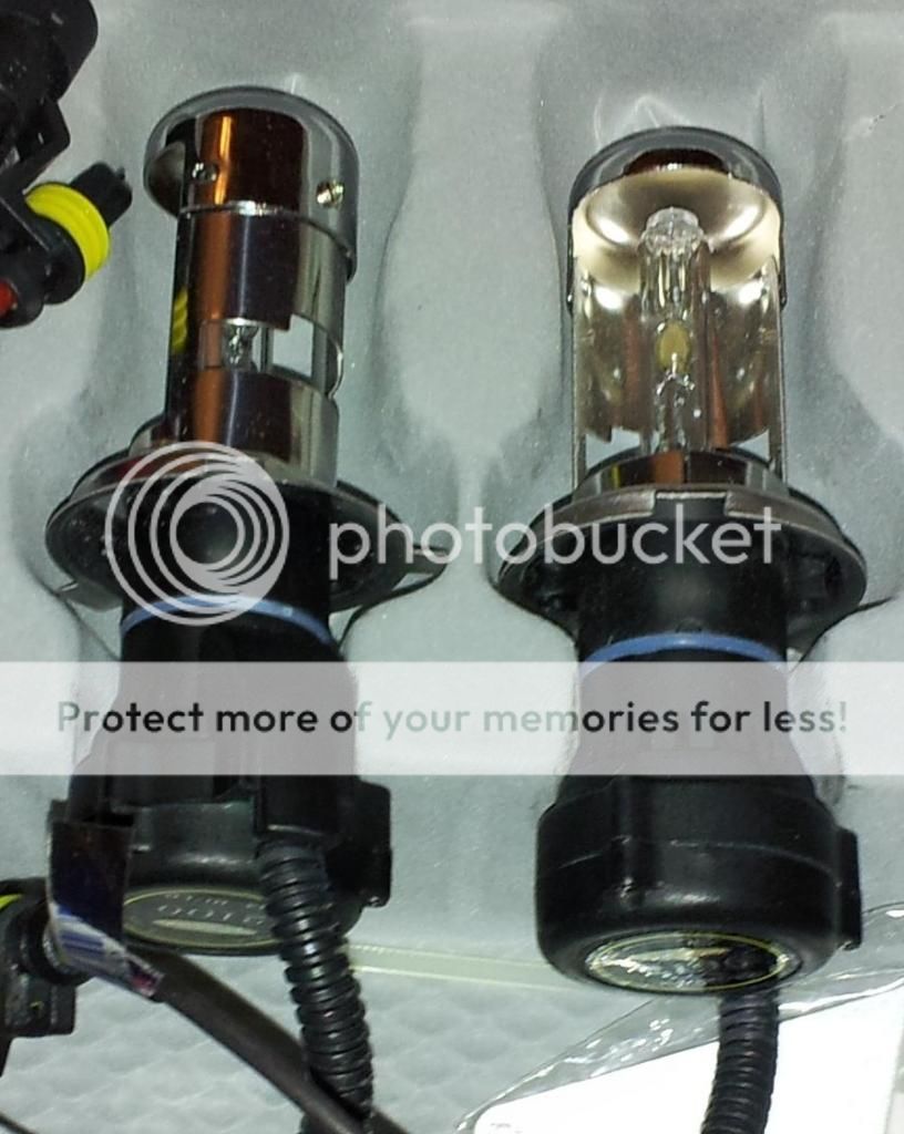

    Here is a picture of the bulbs and shields before I installed them.

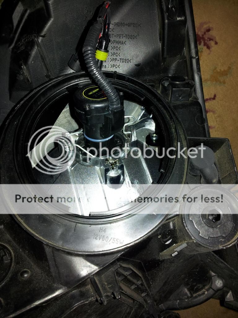

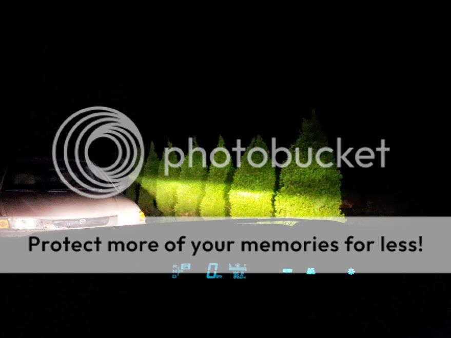

    Here's a picture of the cutoff from the HID Kit.
  18. Daves09prius
    Daves09prius Active Member
    Nov 20, 2010
    680
    161
    Gettysburg, PA

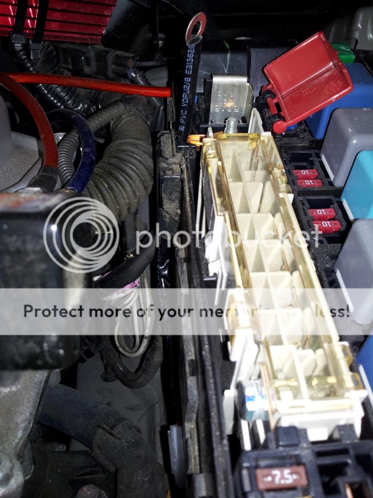

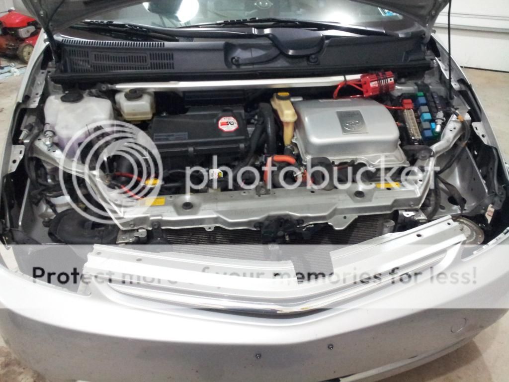

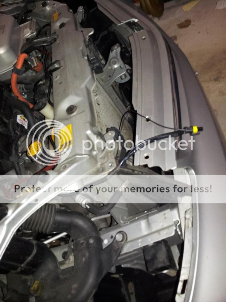

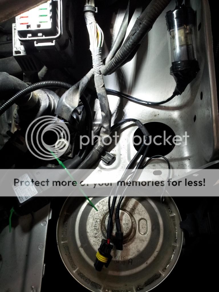

    Install pictures:
    Remove both headlights:

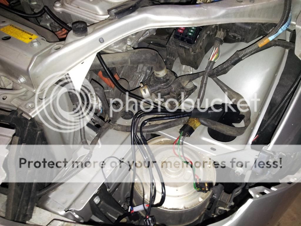

    Lay out wires in drivers (left) headlight area:
    Install controller box and zip-tie in place:

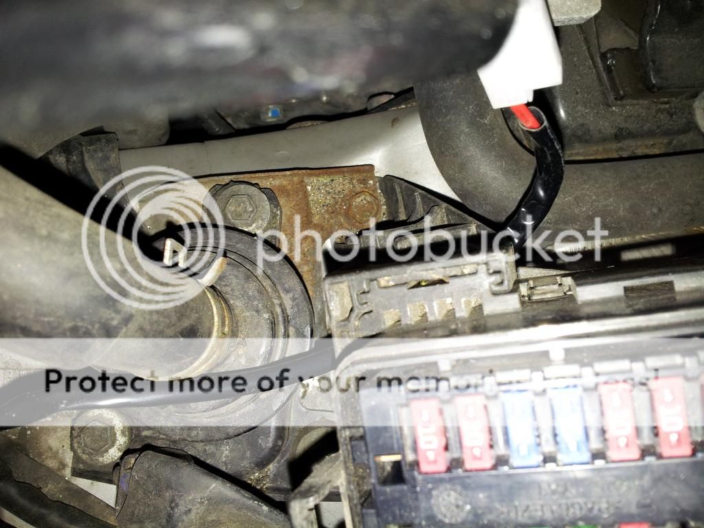

    Run power wire under the fuze box:
    Run power wire up through the bottom of the fuze box
    (this is where you will attach to the positive jump point, Save this step for last.)
    Run wire across the radiator support:

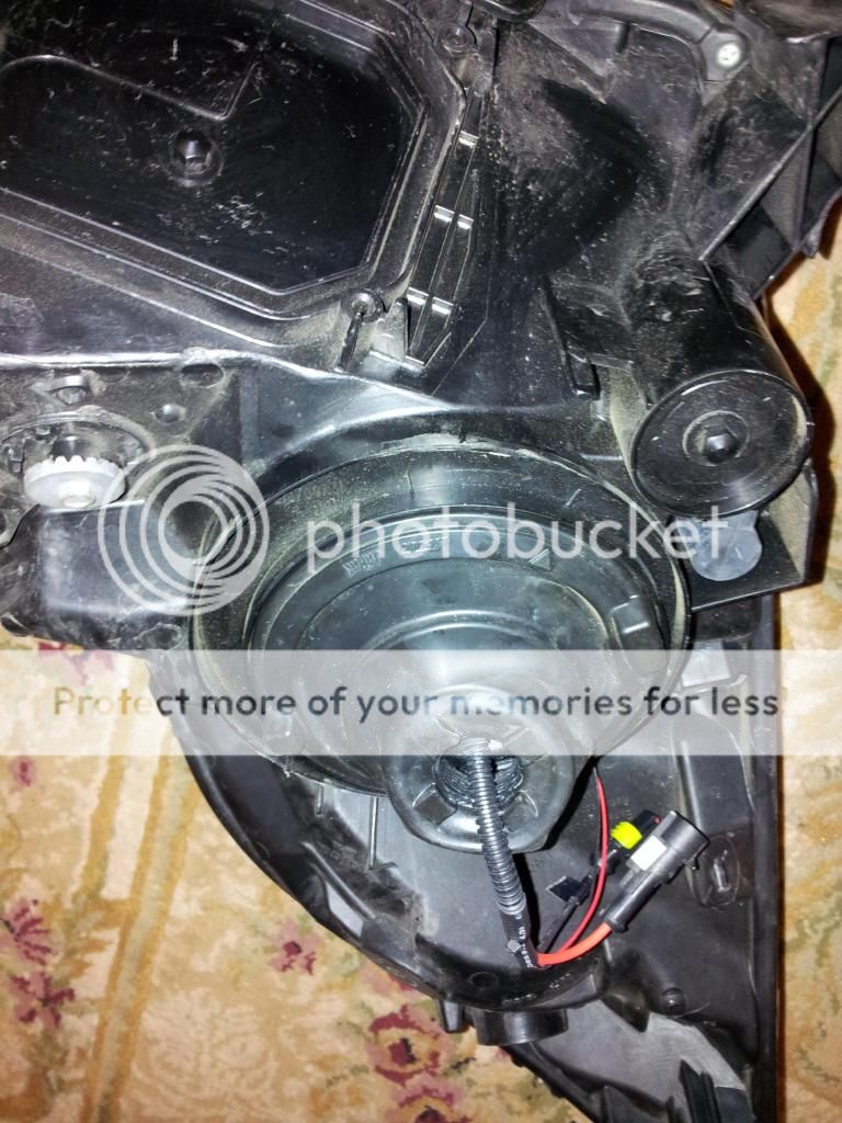

    Install HID bulb and hi/lo motor into headlight assembly:
    Invert rubber cap, slide HID wires through and attach to headlight assembly:
    Driver's side:
    - Zip-tie Ballast in a secure location,
    - Connect ground wire (I connected it to a small bolt on the upper radiator support)
    - Connect wires from headlight assembly to ballast. (each connection is unique).
    - Reinstall Headlight Assembly
    - Do the same for Passenger (right) side.
    - Secure the unused passenger (right) side headlight wiring harness. (I put a small plastic tube from Project7 gum I bought at Wal-mart. Sugar Free Gum - Project 7 - over the unused harness and then taped it with electrical tape)
    - Install Passenger (right) side headlight assembly
    - Connect power wire in fuze box, test lights. If both lights work reassemble front end of vehicle and enjoy!
    If either light does not work, check all the connections, check the inline fuze, check ground wire connections.
    once you've solved your issue assemble the front end.
    - You may have to adjust the alignment of the bulbs after installation. Enjoy!
    caymandiver75 and Mistah Ya like this.

    Nice job and nice find! Can you post another picture of the cutoff against a wall from 25' back or so? I'm thinking we should meet up and do some comparisons one evening. Let me know!

    Nice write up! Where did you get this "Invert rubber cap" you speak of. Did you Halogen Headlamps come with it??
