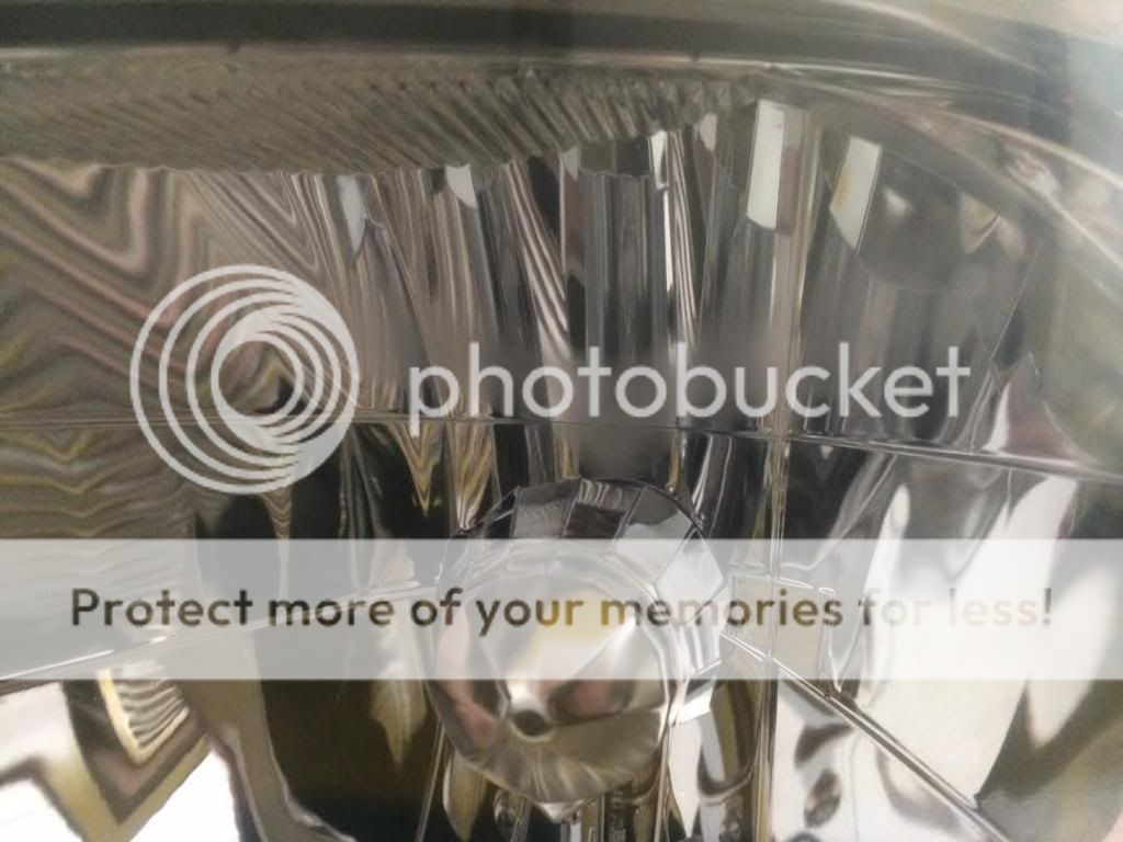

    I did however notice something odd during the bulb change and that is the reflector above the HID bulb appears to be burnt? At first I thought this was condensation, but it is not. I don't know if this is a result of UV exposure from the HID bulbs or what, but I have a feeling it is. See picture below. Anyway, once I get the new ballasts I'm going to be watching this "burn" area to see if it's getting worse and if so I'll be removing the HID kit. :(

    You obviously did not heed my warning. I know what I am talking about here, and this is why cheap bulbs should not be used.
    From the thread I linked you to earlier that you ignored:
    Glass Chambers: You are putting your health at risk and your projectors' chrome lining with cheap bulbs. Not only do the cheap bulbs burn hotter because of less salt, they burn more unstable. The plasma also radiates extremely intense UV rays along with other nasties. If you look at a good bulb you will see an inner chamber made of high temperature glass and an outer chamber sealed by a vacuum made of lower temperature glass but high UV blocking properties. Cheap manufacturers either use low quality outer shielding or some leave it off altogether to save costs. If you ran this bulb and stood infront of the bulb you would get a severe sunburn. Similar things can happen with cracked glass chambers even on high quality bulbs. So there is the obvious health hazard, but to get to the chrome hazards, when it gets too hot the chrome will bubble. When the chrome bubbles, you get uneven spreads and hotspots at best and ignition/fire at worst. Remember you aren't dealing with grandma's bulbs. These are high voltage, high current, and extremely high output lights.

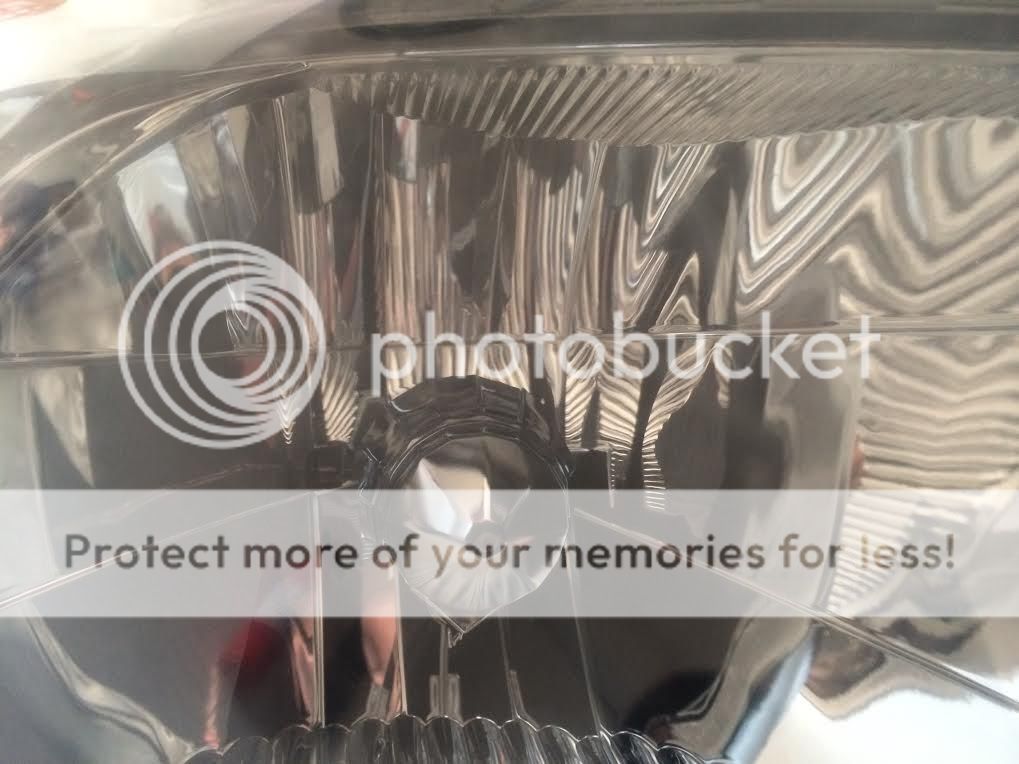

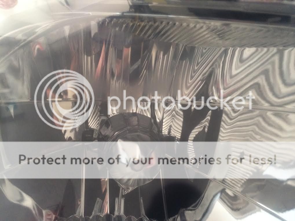

    I may have spoke too soon with regards to the UV reflector issue as there may not have been an issue after all. I just took the light housings off, removed the bulbs (back to Halogen) and out of curiosity I ran a clean towel inside the housing on the reflector where that "burn" appeared. Sure enough it wiped right off and is perfectly smooth again. I don't know what was on the reflectors, but it was NOT burned. It came off as if it was moisture of sorts. Any idea what it may have been? Either way I'm very happy that it was not a UV burn issue or heat issue, but will certainly be keeping an eye on this even with the Halogens.
    Before
    After

    I have seen this blackening effect with halogen bulbs. It is caused by convection currents within the headlamp often made worse by poor or no sealing of the headlamp, "common with Prius headlamps" often causing condensation within trapping fine dust particles that stick to the reflector when it is dried out by the lamp . Exactly the same effect can be seen in domestic lighting situations where the bulb is a relatively short distance from a ceiling or shelf directly over the bulb.
    The heat output of any HID lamp will be lower than the same wattage halogen. The temperature and heat output of the light source are not the same thing.
    One watt of electrical power converted directlyto heat is equal to 3.41 Btu/hr. Since the HID bulb converts more electrical energy to light than halogen bulbs the heat output must be less. Not withstanding this the HID wattage is close to half that of the halogen bulbs normally fitted "33 watts for the HID, 60 watts for the halogen", meaning that even if the HID bulb was no more efficient than the halogen bulb at converting electricity to light "and it clearly is" the heat output would still be close to half that of the halogen.
