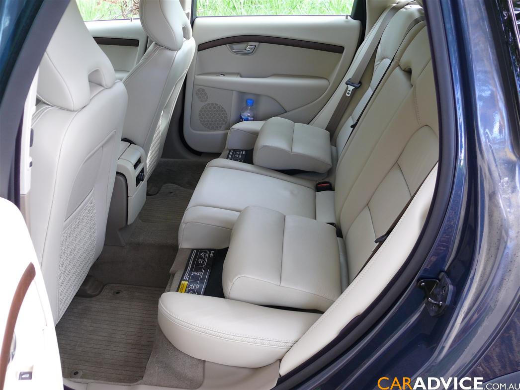

    PS: I got some extra Volvo rearseats for my V70 and they are brilliant with kids (fold up and down without needing an extra booster that is too wide, takes-up-space-when-not-in-use-so-useless-on-holiday, has pins sticking out to loop the seatbelt through, etc.). Can't understand why other brands don't copy this 'en masse'. Don't think I can swap those over. (BTW, the back part of rear seats in the Volvo are literally 3 times the weight of the Prius ones... INSANE!!!)
