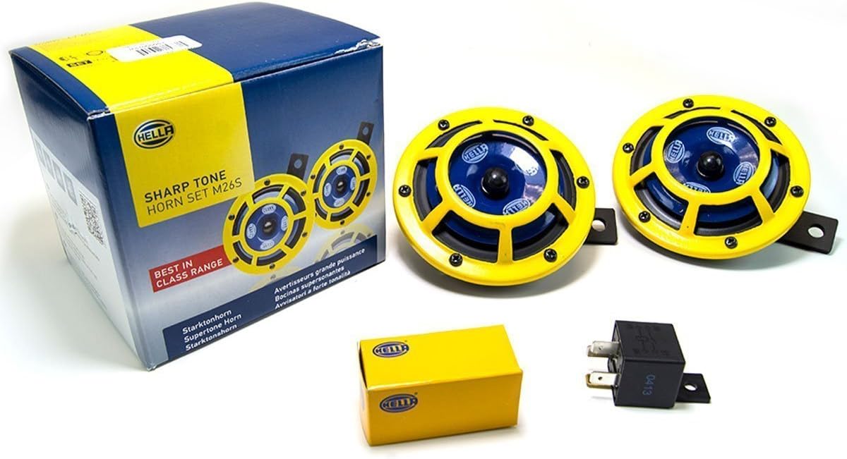

    Thank you for posting this. I installed some Hella Sharptone horns today and it was very easy compared to my 2014 Prius.

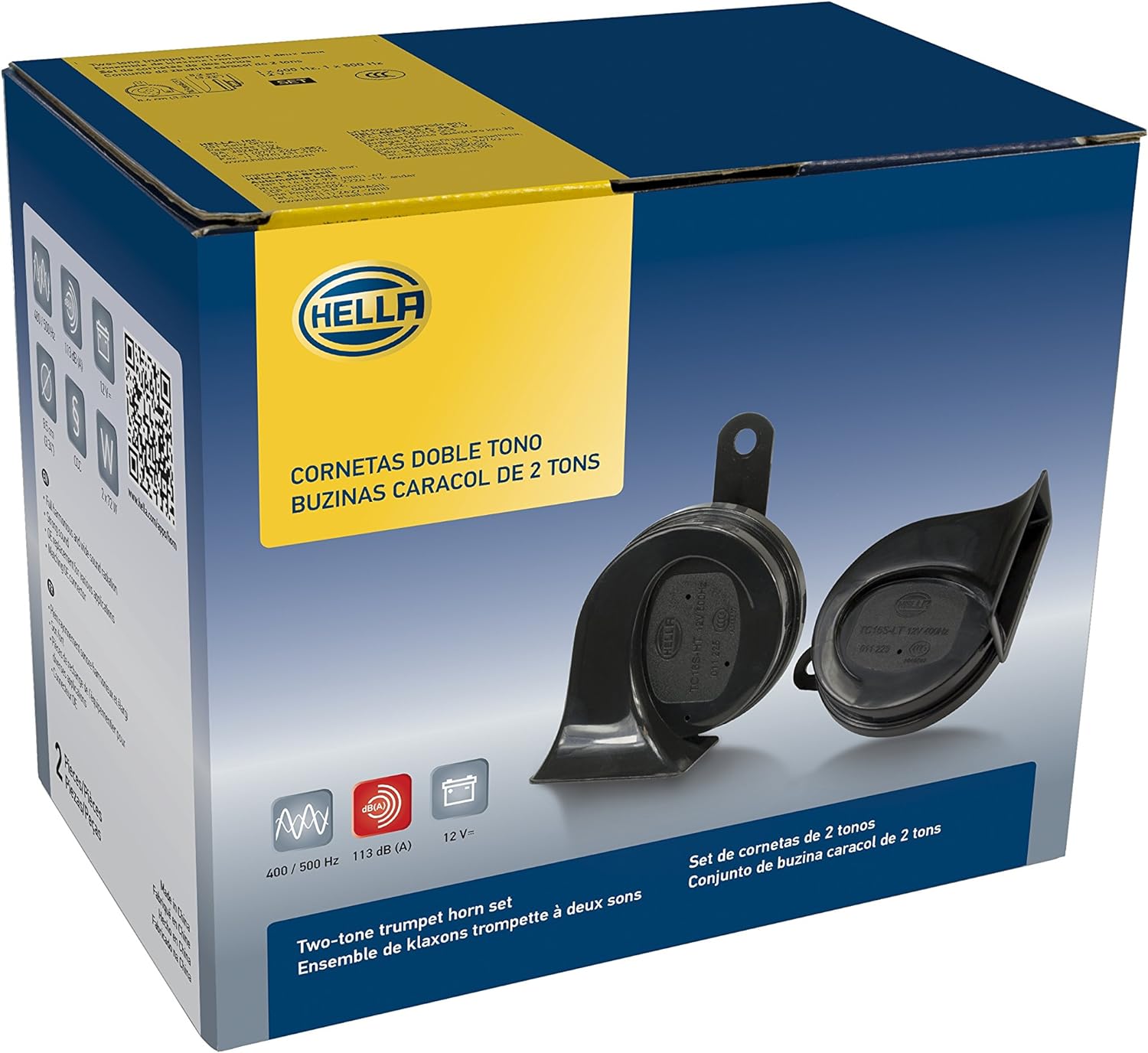

    These are on sale for $20 on Amazon, got a pair for my car.:cool:
  13. chickenhawk
    chickenhawk Member
    Sep 13, 2011
    261
    95
    CA
    I put these Hella horns in and it really wasn't that much louder than the stock horno_O What is the purpose of the relay ? I just plug the harness on one side and the other pin I hooked to ground. I then honked my Highlander horn that was alot louder then this. Wth? So I'm boxing these and sending them back.
    I might try these out. Otherwise I will just get the OEM Highlander horns.

    Well I tried these Hella horns and didn't like the sound ..looks I might use the freeway blaster that I used on my Gen 3 or put in the Highlander horn.
