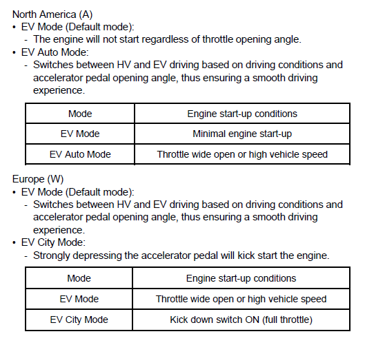

    The wording appears to say that EV City only has the ICE come on when fully depressing the throttle, and that the ICE can come on before that in EV Auto and EU EV. It sounds like EV City is Europe's EV virtually all the time mode, but has that kick down switch to avoid issues like the OP had.
    European "Prime" has different EV mode names | Page 3 | PriusChat
    Some cities in Europe have EV only sections. The European PiP had a low speed EV mode(IIRC called EV City) to operate in those areas. The regular EV mode did have a lower threshold for turning on the ICE in order to preserve battery charge for use in the city.
