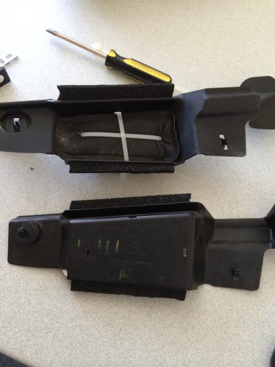

    I just got these and have not seen these pictures so here they are.
    I read about the zip install but have not seen pics.
    I got the 35w 4300k from Retrofit store. You have to order the XB35 bulbs to avoid the ground wire issue that cost +20.00.
    I used a screw driver blade that was hot and melted a perfect slot for the ties.
    Here is the relay install. I did drill a hole with no-ox to keep some rust out.

    It's too bad you drilled that hole in the sheet metal already. If that is the driver's side, then there are a couple of prethreaded 6mm holes in front of the fuse box. I'm using one of them, with a bracket, to mount my DRL module and relay. One of them is in this pic:

    Good point about the factory holes for the next person.
    It was a hard winter with salt, so while I was in there I redid all the ground wires and added no-ox to the connection. That includes the 12v fuse box white wire and the new grounds for the lights.
