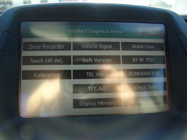

    Did we ever talk about this Product Diagnosis Menu menu? I cant remember if we did or not and I'm not finding anything about it. There is no NAV override in this menu but I would like to know what some functions are.
    To access this screen you do the same dance as before to get to the diag menu, top left, bottom left, top left, bottom left, top left bottom left, then press menu, then press the very top left corner of the screen then the very right bottom corner of the screen.
    The options are...
    Drive Recorder ( What does this do )
    Touch SW Adj. ( Adjust the touch of the touch screen )
    Calibration ( Calibrate the touch of the touch screen )
    Vehicle Signal ( same as on the regular diag menu I think )
    Soft Version ( What software version do I have? )
    TEL Voice ( Looks like some kind of voice adjustment you can do like on the regular menu )
    TFT Adj. ( Adjust the screen color and stuff )
    Display Memory ( What information can be seen here )
    SRAM Clear ( Dont want to try this one but what does it do )
    BT RF TEST ( Looks like a test to see how well your BT phone is connecting? )
    ROM/RAM R/W ( Read and write the ROM/RAM for new firmware? )
    Check Sum ( checks to make sure the loaded firmware is correct? )
    Data Logging ( Looks like you have to hold this one down to enter but What does this do )
    I'm not responsible for any damage to your Prius if you go messing around in here!

    Press and hold the the bottom left corner on this screen for 30 seconds to get to another screen.
