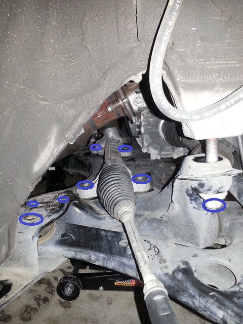

  12. Justdidit
    Justdidit LVNPZEV
    Jun 12, 2012
    1,880
    711
    75
    Carrollton, Texas
    Four Touring
    I took a few pictures: Modding My 2008 Touring...."JustDidIt" | Page 7 | PriusChat
    Some of the in-line links are broken but the attachments still work.
