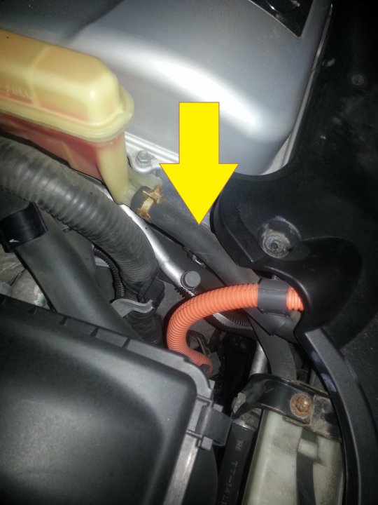

    OK, as Britprius said the swedish prius dosen´t have the storage tank. Don´t know why:confused:
    so can I install the heating pump on this hose? and in which direction?

    No, That hose appears to be carrying the coolant for the inverter, not the ICE.
