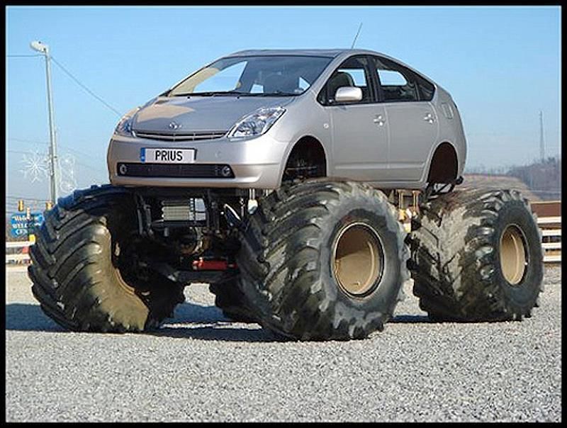

    I've been seriously thinking about lifting my Prius for a while. It's not easy driving through the hills I live around with a low bearing car, and I also love driving off road.
    I do like the size of the second image. If I am successful at fixing the piston rings I'll likely be looking to do this next. I wonder how much a lift kit would affect the MPGs, because it would make for some great long distance trips out into the Nevada deserts. I'd be doing this is on a 2006 project car I bought to fix up and mess with. I'm currently a quarter way done with reconditioning the battery.
