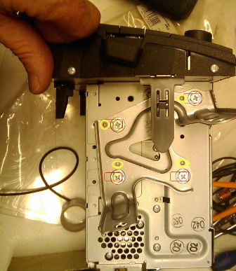

    I said earlier , I had to adjust the position of the new nav_unit.
    on the following picture:
    I removed the points with yellow circle
    and I used a dremel tool to make bigger the fixing holes (red parts).
    this picture was made with the OEM radio before changes.
    I promised some new pictures, but there is some delay because my cam is out of service.
