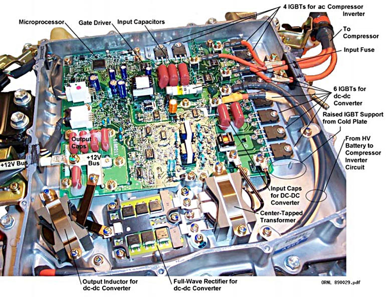

    Here is a picture of a gen 2 Inverter by Hobbit, the lower left corner seems to be the 201 v to 12 v DC to DC inverter, the 12 v cable exits on the left.
    The c will be different, if only because the HV Battery is 144 v.
