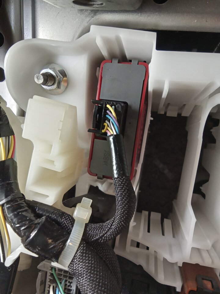

    It would be easy for you to do. On any Gen 3 Prius, it's the same jumper between pins 5 and 6.
    That's the two wires on the left bottom.
    It took me three days and about nine hours and many removals of the connector block to figure it out.
    I used a short piece of wire from a Cat5 cable, but any piece of 24 ir 22 gauge solid copper wire will do.
    Now that I know, anyone can do it in 20 to 30 minutes with no tools.
    All that's needs to be done is to squeeze the sides of the glove compartment and to hinge it down.
    That provides full access to the TPMS. computer..
    The connector's block doesn't even have to be removed.
    Just insert the ends of the jumper into the back of positions 5 and 6 on the two vertical positions on the lower right.
    If you replace the tires without TPMS sensors with those that have them, just remove the jumper.
    No wire cutting or splicing is necessary.
    With the jumper removed, there is no trace of this modification.
    This would be great for states that would fail a vehicle inspection for a TPMS fault.

    I just started to jumper as many combinations as possible and started the car. None damaged anything. Just worked or didn't work at turning off the light.
    Eventually, I found that the pink wire or pink with stripe wire on almost all Toyota and Lexus cancels the TPMS light on the dash.
    Just try jumpering to most likely the blue wire. If that doesn't work, just try con̈necting others until it works to turn off the light.
