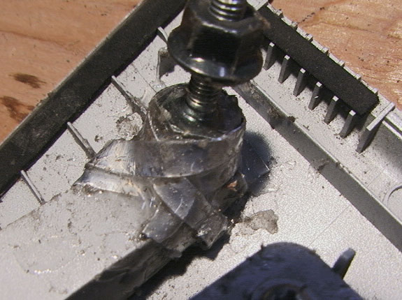

    The plastic can be repaired in 2 or 3 steps:
    1. superglue the broken plastic back together to hold the bolts at the right angle,
    2. cut a couple of strips of aluminum shim (not tape) about 1/4 inch wide and about 3 inches long, smear thick "Automotive Goop" on the relative surfaces and wrap the aluminum strips around so they'll hold the broken parts in place when hardened. it's messy anyway but it can be less so if you shape the parts w/ pliers before you put glue on them. Goop cleans up w/ gasoline or thinner. Leave it over night. When it gets solid, press the aluminum into closer contact with the plastic & bolts using a screwdriver and push more goop into any open spaces w/ your fingers. If you want it to NEVER break again, (good luck) use several layers that extend farther away from the bolts to spread the stress over a larger area.
    3. the thickness of the aluminum will make the trunk handle set slightly farther away from the door when the bolts are tightened, so before you remount it, lightly dent around the bolt holes in the door w/ a small hammer so the holes will be slightly recessed from the outside, by about the thickness of the aluminum (<1/16 inch). it matters.
    good luck :)

    I simply replaced the plastic snaps with bolts and it has since stayed in place.
    NoSpam likes this.

    I repaired my 2005's dangling hatch a year ago. More solid that OEM now. If you take off the parts you can see the plastic that breaks from use. Just drill a new hole next to it and put the bolt through the new hole. Super easy.
    NoSpam likes this.
