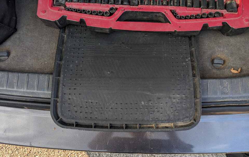

    2) Cover the tailgate latch. I used one of my car's floor mats. (Click on the thumbnail for a larger image.)
    Why do this? You'll need to swap over the latch release switch and the wiring harness it's attached to. If you close the tailgate while that's disconnected, the only way to open it again will be to climb into the car and use the mechanical emergency release, which is a PITA to get to. By covering the latch, you keep it from latching even if you close the tailgate (which I needed to do while I went in the house to faff about with the wiring harness (see #4 below.))

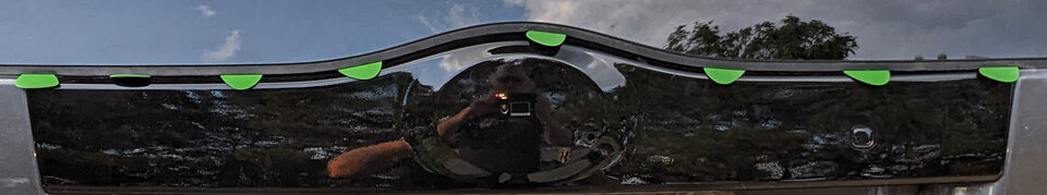

    5) There's a rubber seal permanently mounted to the tailgate. You have to tuck the top edge of the garnish up underneath it -- but when you do that, the rubber tends to get caught on the garnish and curl up underneath, which means it won't make a good seal.
    I bought a package of guitar picks to use as temporary shims. I tried to avoid using them to forcibly uncurl the rubber; that would have risked damaging it, and so buying myself a world of trouble -- the rubber would be a lot harder to replace than the garnish.
    Instead, I tucked one end of the garnish up under the rubber (the first end is easy), then slowly raised the other end, inserting enough guitar picks as I went to keep the rubber from curling in the first place.
    The picks are only needed until the garnish is installed and fully tightened down; then they're easy to remove.
