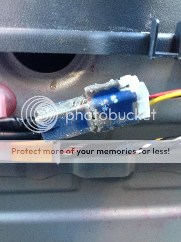

    Yes, as previously stated all the locking functions are working. I can lock and unlock the car from the hatch as well as the driver and passenger doors. I took a look at the wiring harness and the connector is corroding. Based on how badly (looks like it's melting) my guess is it's been like that for a while now and probably got jarred by the spare tire. I'm not sure how common it is for these plugs to start melting but based on the above provided link, I'm not the only one. Perhaps another recall is in order?

    The wiring harness did turn out to be the cause of my problem. The plug is in real bad shape and I don't know what would cause this to occur. There is no sign of any other corrosion or water intrusion anywhere else in the trunk. I[​IMG] pulled it apart, sprayed electrical cleaner on it, and put it back together. Voila! It now opens again.

    Good catch. You may have water ingress into trunk that has now dried up. Pull the spare tire out and look real close in the well under the tire and with a flashlight look into the well where the base of the 12 volt battery sits. See if you see signs of water that has dried up like rust etc. Many reports of water leak into that area from various cracked weld seams. Your car is not a rebuild from an accident is it?

    Being a new owner and interested in learning more about this great little car, I love this kind of thread where there was a problem presented, questions asked and suggestions made, and finally the issue uncovered and repaired, and with pictures!! A great resource, thank you guys.
    At the risk of belaboring the issue, other than water creeping in and flooding this area, which seems not to be the case, do some of you, that are more electronically knowledgeable than I, have any ideas why this connector would disintegrate like this in 6 years? I recall a child's electric car that our son rode for hours each day had a similar looking connector that got very hot and also began to disintegrate. I wonder if a heat issue inside the connector could be a factor? If not, what else could cause this?

    Since well is dry may be the connector overheated from excessive load like it melted like the electric hatch mech was pulling way to much current. Never seen any reports of that here. You have a one off odd issue. I would cut that harness out and bypass with crimps.
    Might want to do a simple test and open the door and turn on headlights and then while watching the headlight strength open the back hatch and see how much the headlights dim during the release. The release mech may be messed up. i doubt the lights should dim at all. But can't recall any reports of that other than the outside rubber handle melting which my car had also.
    Or there was some corrosion on the connector itself creating resistance which cause heat and will melt the plug. But thats weird to as the hatch release is so quick a current draw. Just plain weird.
