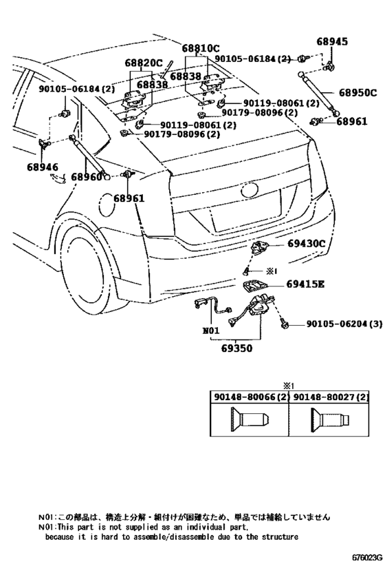

    You are talking about details:
    68950-0W540
    Stay Assy, Back Door, Rh BACK DOOR, RH
    68960-0W530
    Stay Assy, Back Door, Lh BACK DOOR, LH
    there are others 68960-0W531, 68960-0W532

    The genuine Toyota are probably best bet. That said, ours started weakening within a few years of ownership. Looking up the above part numbers I see mention of them being revised, hopefully improved longevity. A just across the border from me (in Canada) shows them at $35 USD apiece.
    I went with a Priuschatters recommendation, got thiese through Rock Auto:
    Strongarm STRD7088
    For $10.02 USD apiece, plus $13.99 shipping, to my Canadian address.
    Initially they were too strong on the uplift, not insanely so, and I accomodated by keeping a hand on the hatch as it went up. That was about a year back, and they seem to have mellowed.
