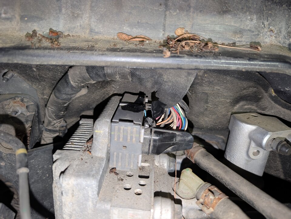

    My 2012 Prius (not sure the sub-model) started doing this the other day. All the dash lights came on as well. I found a youtube video of the diagnosis, it was the anti-skid eco. Unfortunately, I can't find mine in the same place as the video...
    Not sure if we're allowed to post links here, but if you google '2012 prius hazard lights blinking constantly' it will be the first result in the list
    Does anyone know how to get to the anti-skid ECU?
  13. ChapmanF
    28,714
    19,011
    It's this gizmo, mounted on the firewall in the engine compartment, right where the brake pedal is (the pushrod you see attaches to the pedal).
    It's one unit that's the ECU (inside the flat ribbed side you're looking at here), plus the master cylinder, booster, stroke simulator, and actuator. The ECU doesn't come separately.
    The goofy-hazards business is common enough to be known around here. Here is the thread you'll want.

    This happened to me last week. From advice from this chat and other forums I fixed it by accessing the abs ecu and snipping the blue wire. sofar everything seems to work okay including my hazards and signals but they don't go crazy with wheel speed.
    Easy steps:
    1. remove wiper arms - 3 bolts I think 14mm i used 1/2", the single blade you need to pop the plastic cap off with a flathead.
    2. remove plastic cowl, just snaps off. there's two separate corner pieces too
    3. remove wiper motor - 4 bolts, 10mm and slide it out
    4. remove metal cowl - not sure how many 10mm bolts
    5. find ecu - mine had a little plastic guard I broke a little bit trying to remove
    6. find light blue wire on top, should only be one. snip it and tape ends for safety. I also saw some people
