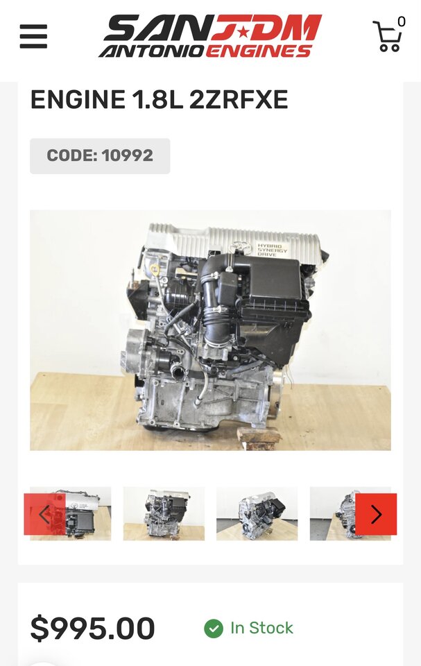

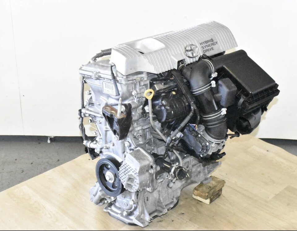

    I can't believe you did not replace the engine especially in this case. A Jdm for $1,200 is easier than the head gasket job with a rebuilt head.

    Man! If I'd known about that, I probably would have. I just checked it out and it's $1,199.00 delivered, and is complete: head, cover, intake, throttle, EGR. I guess it's used, low-mileage--not rebuilt, right?
  11. rjparker
    rjparker Tu Humilde Sirviente
    Jun 6, 2008
    11,005
    6,895
    Texas Hill Country
    yes JDM used in Japan - some as recently as 2021

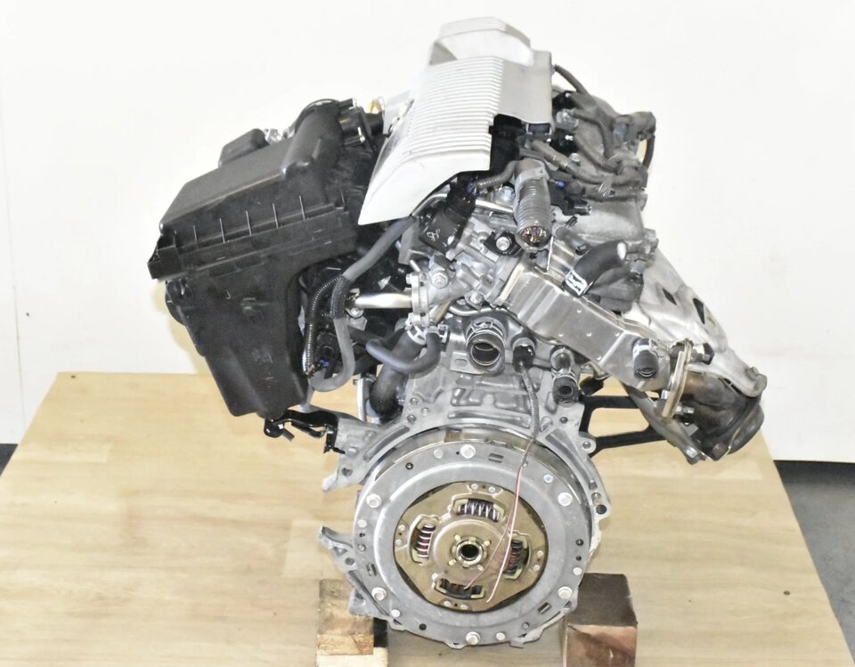

  13. rjparker
    Jun 6, 2008
    11,005
    6,895
    Texas Hill Country
    That is another jdm engine candidate. Comes complete with an intake and egr system so you could junk yours.
