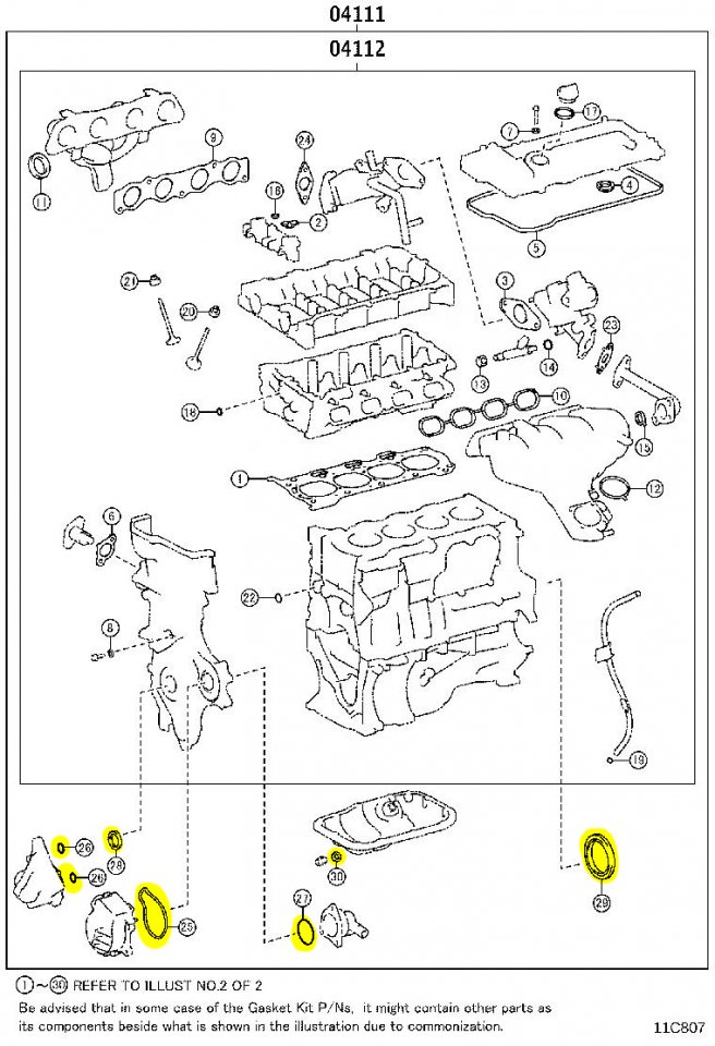

    Wow, almost asked them for a quote. And they made a video about some other shop ripping off a lady in one of their videos. What HG did you end up buying? Autozone has 2: 1 is the HG only and the other is a set. Did you replace the head bolts too? I am planning to do it slowly.
  18. Mr. F
    Mr. F Active Member
    Sep 21, 2020
    390
    264
    Washington
    I used the OEM engine overhaul gasket kit (04111-37316).
    There is another OEM kit (04112-37254) which has 7 fewer gaskets and costs a little less. The ones not included in 04112 are highlighted in the image below:
    I did replace all the head bolts. Since one had actually sheared off for me, I'm glad I had the entire set at hand.
