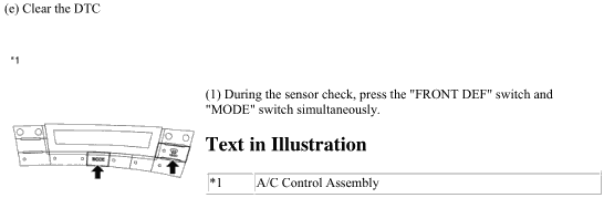

    is there a way to clear the 72 code out of the AC system. I saw online if you hold the front and rear defrost that it should clear this. But it didn’t work on my 2012 Prius. Is there another way to clear it? I’ve already disconnected the battery for a long period of time that didn’t do it. One post somebody
  19. ChapmanF
    28,308
    18,753
      File size:
      3.7 KB
      Views:
  20. rjparker
    rjparker Tu Humilde Sirviente
    Jun 6, 2008
    10,713
    6,727
    Texas Hill Country
    Techstream or any scanner capable of reading the AIR CONDITIONER ecu (CLIMATE/HEAT in Car Scanner app) can also attempt to reset the code. But if the fault is still there the code will be back very quickly.
