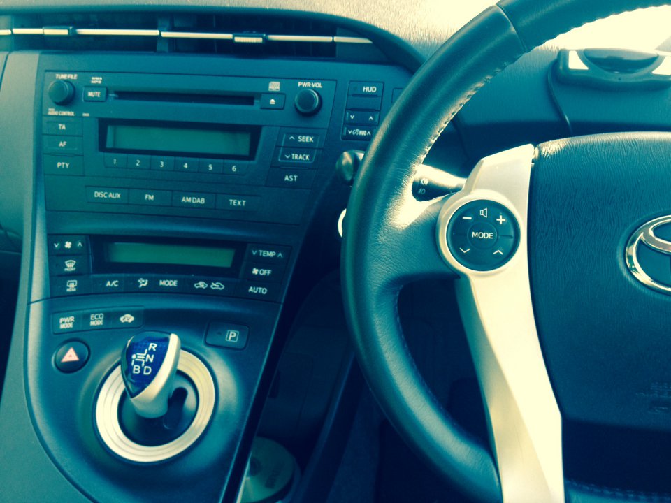

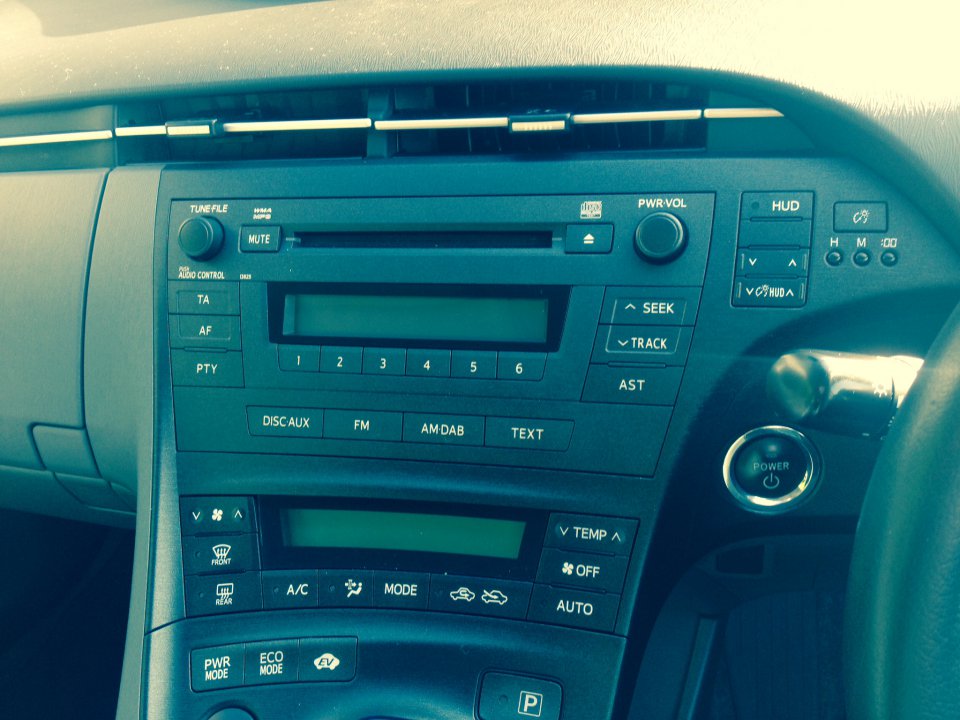

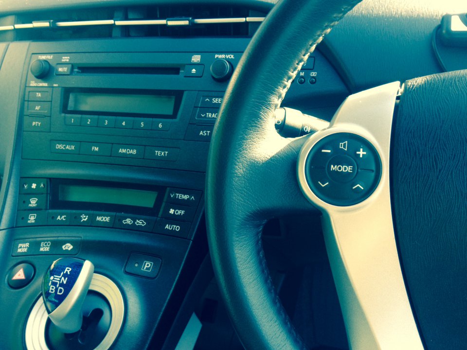

    Thanks Frodoz737, just had a look, couldnt see speakers on back door upper trim nor an amplifier, think its just base radio. here are some picture of my car might help. photo 1.JPG photo 1.JPG photo 2.JPG

    My US 2010 Prius II came with the base radio. Without knowing all the details, this likely is our equivalent of what you have based on description and photos. Do not install any other Toyota Prius factory upgrade radio as they are all junk. The 2012 NAV unit you mentioned (SAT and camera plug-in capable) will not "directly" interface, plus the amp that it requires is junk just like the speakers. Your Electrician could do a modified install with "all the parts" taken from the donor car and the proper wiring diagrams, but the return would be disappointing. To keep it simple I would recommend just upgrading your base system with an after-market NAV-HU and better speakers if that's what you want. SAT, cameras and steering wheel control interface are easily done with the right unit. I went all out with my linked install, and that might not be what you had in mine, but it may give you some ideas and options. Hope that helps.
