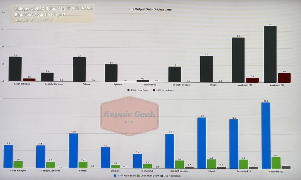

    Auxbeam F15 - Low beam at distance is what matters

    Haven't tried F series yet . I'm still fanless on s 1 and 2. They don't have this chart for the S series oh well. They no Make anymore .

    Interesting data.
