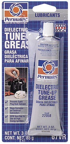

    I put a minute amount of silicone on the gasket - no more screwing around to get the bulbs straight, they really just slide in perfectly /

    would love to hear more about this, which silicone did you use and how does it help?

    this one:
    Permatex 22058 Dielectric Tune-Up Grease, 3 oz. Tube
    without a small amount of this grease I had a lot of friction resistance between the bulb & the housing; it was pretty much impossible to feel with the fingers when the bulb was seated/
    now with the minute (I emphasize the minute; you really just need very very little grease) amount of grease smeared on the bulb gasket you're able to turn the bulb way easier & you can really feel the bulb 'click' into the housing/

    hmm... i may have to give that a try once the stores open again. i was driving around for a little bit just now and got a faint whiff of that sort of burning smell. both headlights felt about the same as far as warmth goes but the passenger side was warm in slightly different places. so once it cools down i'll have a peek. no visible damage or change in performance yet.

    weirdly, i did find the (possible) source of the smell- the bulb itself. not sure what to make of that. i took it upstairs to see if had some alcohol to clean it off and noticed the smell followed me. i did see what appeared to be some residual silicone around the entry point- maybe a few specks of that got on the bulb from all the twisting and fussing, i don't know.
