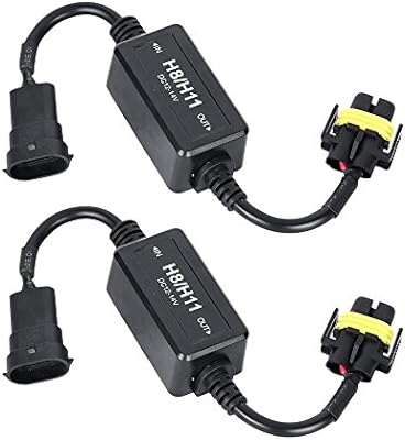

    I read somewhere that you shouldn't go above 50w those you posted are 72w , also you need this to avoid flickering
    Error Free Wiring Harness Adapter
