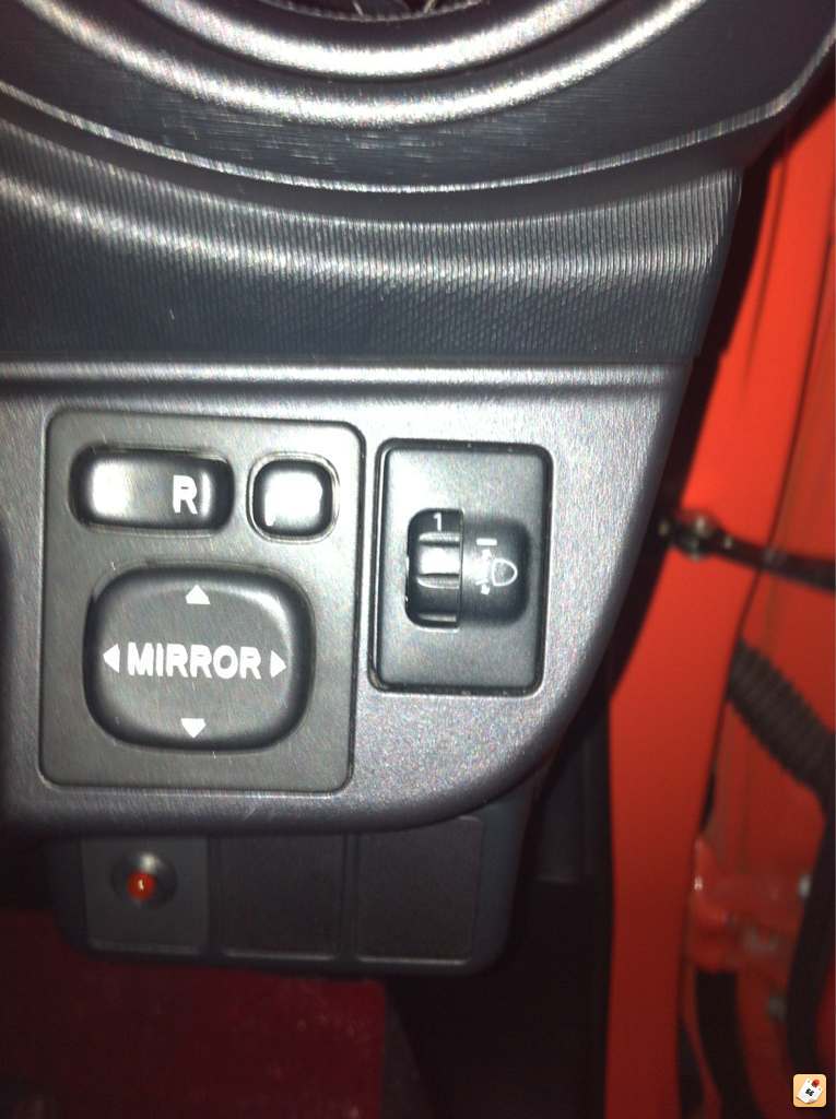

    Isn't prius c got manual headlight adjuster at the driver side ? And auto adjuster for led light c4 ?

    US cars don't get the led or the auto adjuster.

  13. kevtan
    kevtan Member
    Aug 31, 2013
    30
    I mean got knob to manually adjust the light at driver side adjust for up and down

    What I mean is this manual knob to adjust up and down .

    US cars don't have that. We have our interior light adjuster there.
