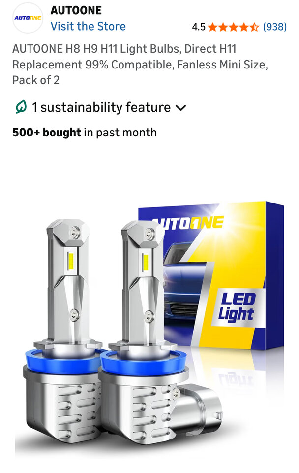

    Third and perhaps the strongest low beams are led retrofit bulbs. These are technically illegal in most states and are sold as h11 foglights. They are all aftermarket and most fail quickly, blind oncoming drivers, sometimes cause interference to the cars computers and or cost a lot. Most have annoyingly loud fans to dissipate heat. One possible exception other than possible legality is the "AUTOONE H8 H9 H11 Light Bulbs, Direct H11 Replacement 99% Compatible, Fanless Mini Size"
