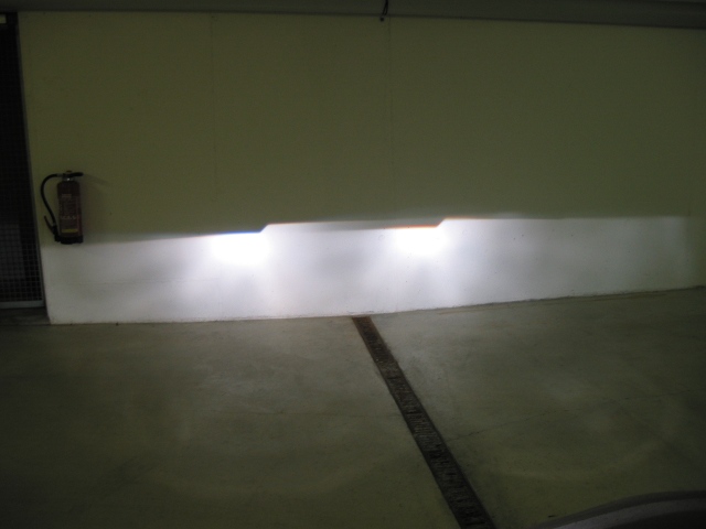

    I sure hope you don't expect anything but looks from the eBay projector headlights.
    They may 'look' like an improvement but they will never compare to a true retrofit like mine, F8L or many others who have spent the time and effort ...and $$$ to do it the best way. Here is a thread about the quality and their install of the eBay projectors.. Projector Headlights from eBay for the Gen II | PriusChat
    Yuck.. very narrow beam
    The cutoff is very narrow because of cheap lens and projector bowls in the ebay lights.
    Example of a true retrofit.
