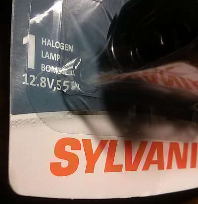

    You might want to scan the package closely for an actual voltage rating; there might be one like this:

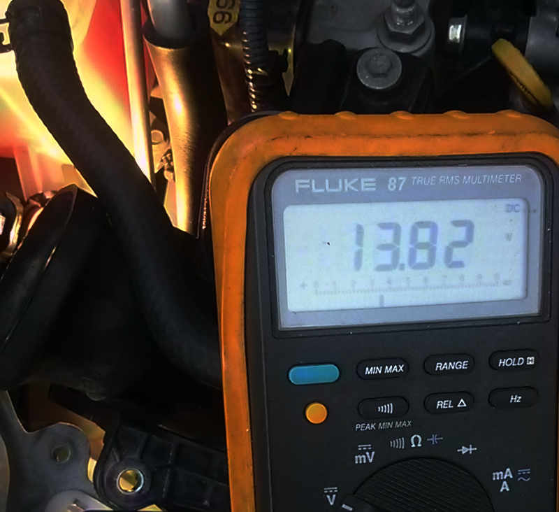

    Still, your measured voltage appears to be above it, and also about half a volt lower than what I measured in my 2010 (which has the notorious eats_low_beams property):
    The fix that Toyota distributed for the eats_low_beams cars was a harness extension built to drop an extra half volt or so—which would mean the voltage you're seeing is (a) probably about what Toyota intended, and (b) above your bulb's likely design voltage (unless yours is quite different when you check the package).
    If those things are true, then it would seem you are already getting light that is brighter and bluer than what your bulb would produce at its rated voltage, and the question would shift to why it looks dim and orangey to you, like, what are you comparing it to?
