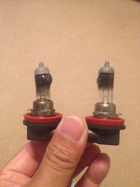

    Figured it out. And I'm an idiot but maybe there are others that aren't as smart as some of you guys. So I have 2 kits in my Camry. And have 6 oem bulbs sitting around. I used Camry bulbs in the prius by accident. Plugged in the right bulbs and my lights are fine. But the Prius electrical bubbled up the oem bulbs. So make sure you use proper bulbs lol. Thanks for the help everyone.

    That's ridiculous. A bulb is a bulb, there are no Prius bulbs and Camry bulbs lol. If it's an H11 bulb, it's an H11 bulb.
    I've interchanged the bulbs between our Prius and Camry many times with no problems.
    Those bulb capsules do look really strange though. It suggests extreme heat exposure. It's surprising that you didn't blow any fuses, must've shorted something out.

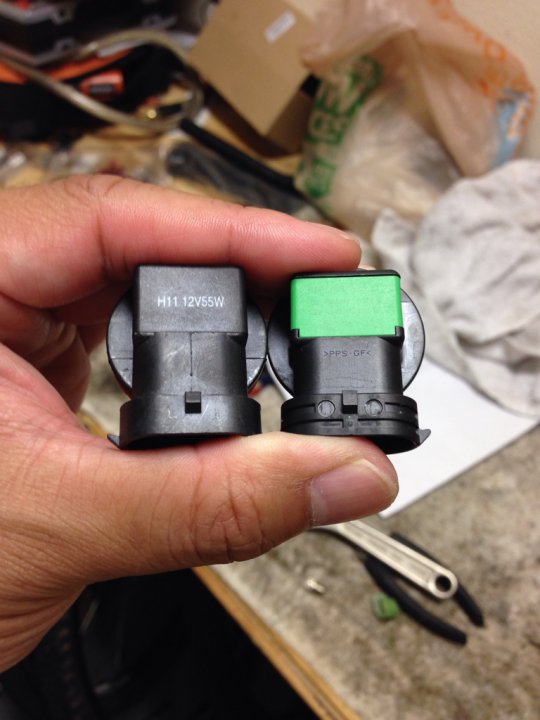

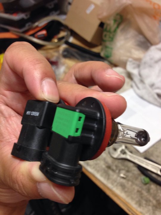

    I agree bulbs are bulbs which is why I didn't think twice about what I'm installing. However the Prius bulbs look like they might have something extra on them like a resistor inside maybe? There's a small cover on the body housing of the bulb.

  13. BreitrthnU
    BreitrthnU Can you smell the premix?
    Mar 24, 2012
    255
    Tampa, FL
    Again I agree, but why would one work and not the other. They are both h11. ImageUploadedByTapatalk1413682421.904812.jpg ImageUploadedByTapatalk1413682441.354298.jpg
  14. Jonny Zero
    Jonny Zero Giggidy
    Jun 22, 2012
    1,388
    352
    Austin, TX
    Did you hook the HV output from the HID ballast to the halogen bulbs? They look fried.

    Those H11s are Quartz- Halogens - which means that they have a quartz (not glass) envelope. For them to have bubbled like that is beyond odd. Did you plug them into an HID ballast - which is meant (ONLY) for HID bulbs??

    OR, did you put your fingers on the bulbs? Finger prints will cause them to overheat.
