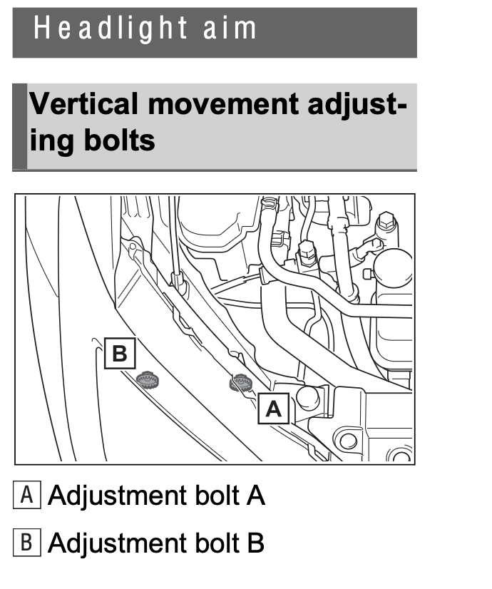

  2. Paul Gregory

    Dec 9, 2022
    2,340
    614
    Alberta
    2024 Prius Prime
