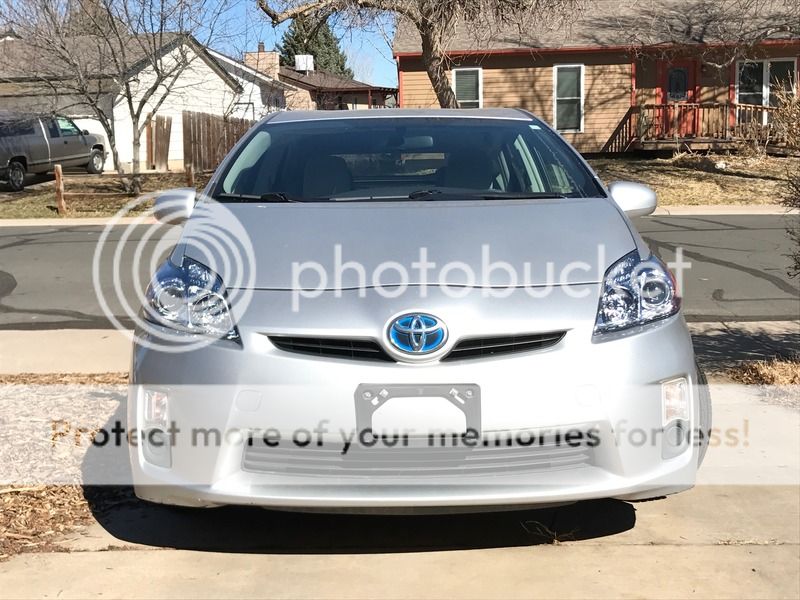

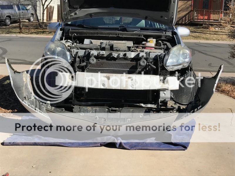

    Just replaced both headlight assemblies and all 8 bulbs (LED side marker and parking light and Ultra Star halogens for the low and high beams).
    Given how easy and quick it is to remove the bumper and assemblies, this is the route I'm going to go when it comes time to changing the bulbs. I do not want to risk breaking the retainer ring or damaging the assemblies when trying to get my hand into that space (the size of a wine bottle opening) behind the headlights.
    And I only broke one brittle push pin clip in the process. I should get an award or something.
