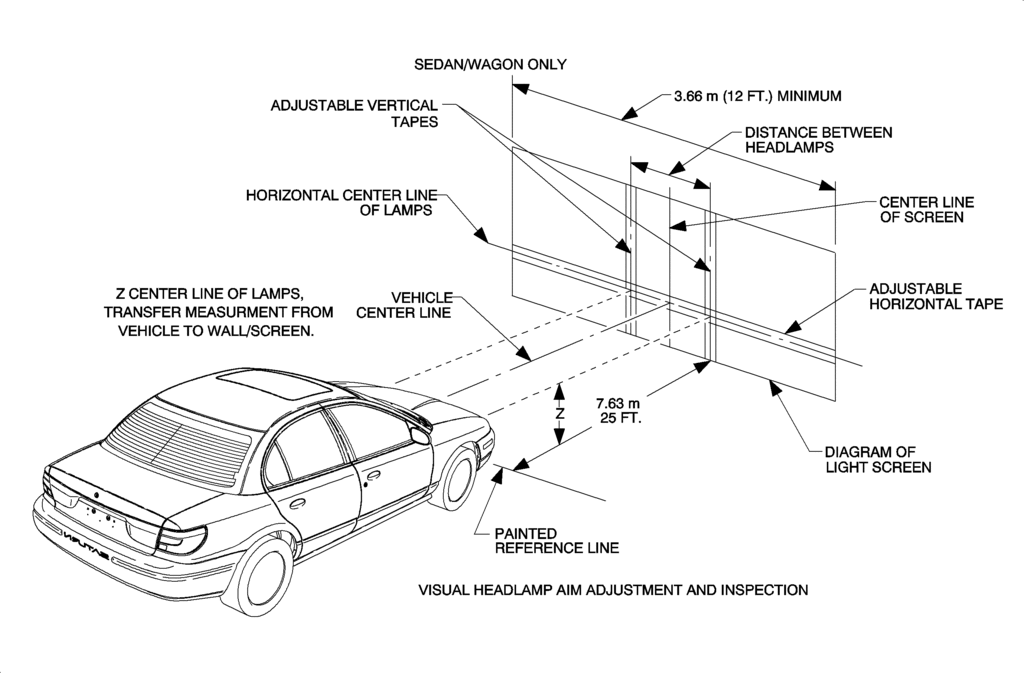

    SUV vs. car doesn't matter much, it is all about the type of light and where it is thrown. A higher riding vehicle's lights are pointed more downwards than a lower riding vehicle illuminating about the same amount. If you point them too far down, you make a huge bright spot and blind yourself. If you point them too far out, no light hits the road and you will be blind.
    Go find a level piece of ground with a nice flat wall. I like going to the nearest big box store like a WalMart or a mall or whatever. Usually they are large monolithic type buildings with square level walls and level graded lots especially by the loading bays.
    Drive right up to the wall and measure where the headlight bulb is. You can estimate, but usually the super bright point (you are almost touching the wall with your bumper...) is the bulb height. I like to mark it with blue painter's tape. Do both lights. Now back up 25ft, straight back. Where on the wall is the light in relation to the tape? It should be 2 inches lower than the tape. If it is higher than the tape, then big big problem, no light is hitting the road. If it is way too low or not even hitting the wall, then most of the light is making a hot spot.
    In the diagram, the height Z is the bulb level itself at the vehicle and bulb level minus 2 inches at the wall 25ft away. While in there you should check the horizontal alignment. That shouldn't change. So if the hotspot has moved over to the left or right even with the correct height, you should adjust it back into alignment with the screws.
