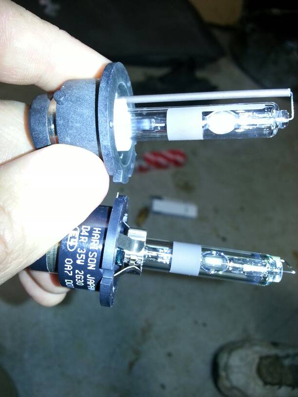

  11. windstrings
    windstrings Certified Prius Breeder
    Sep 11, 2005
    6,280
    378
    Central Texas
    Here is a genuine Toyota bulb below "new" , and an aftermarket D4R above "used but still works ok" .
    Looks like better heat dissipation from the lower toyota bulb.
    The bad bulb "not shown in the picture" appears to have heat burns on the metal exterior of the bulb leaving it a red/rusty color. It was turning off every few minutes and would need a restrike to get going again.
