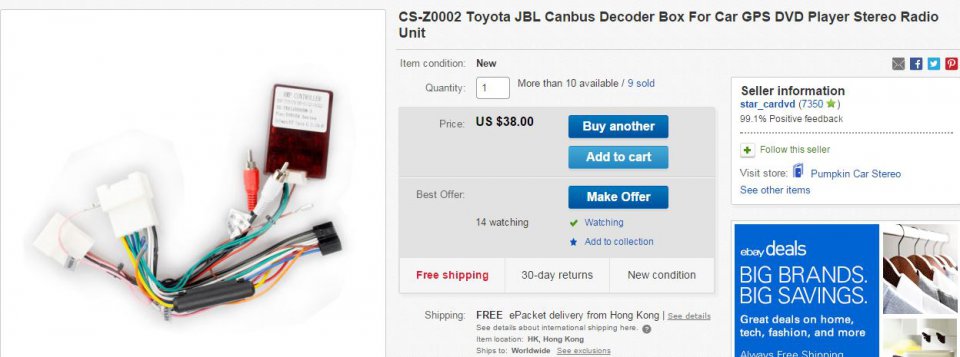

    I finally installed the radio, and like it very much. The JBL system works as it should thanks to the adapter. I've copied the review which I listed on Amazon to help others over there.
    JBL RADIO:
    I have a JBL-equipped 2010 Prius and had to purchase a separate adapter for $40, again via eBay. The correct adapter is KD-Z0002. DO NOT let them send you CS-Z0002. Make sure if you need this JBL adapter, you verify they send you the right one. These come from China and can take quite a while -- 3-4 weeks -- if they send the incorrect harness (like the did for me.) The audio quality is the same as the stock radio. BUT, the benefit of this radio is the EQ band is highly adjustable. Very nice. The front/rear fade doesn't work right, as expected, because of the intricacies of the JBL system; if you try to fade it to the rear, you get no audio from any speaker. Overall, the audio quality is outstanding and it gets quite loud, with ease. Volume level 1 on this radio is equivalent to Volume level 5 or 6 on the stock radio.
    WHEN INSTALLING IN A JBL-EQUIPPED CAR:
    Step 1: Before removing the stock radio, turn to FM and turn up the volume to level 45 (yes, 45.) Set Bass, Mid, Treble, Fade, Balance all to 0 (zero). Let that stay on for about 5 seconds, then turn off the radio, then the car. Now, you can remove the stock radio.
    Step 2: Install the JBL harness and the Android radio, but do not turn on yet.
    Step 3: VERY IMPORTANT: To prime the JBL system to work properly with the new radio do the following: Turn the car to 'ON' for 2-3 seconds, then quickly turn the car OFF. Do this step 2 times in a row. (Note: you may not see the radio screen turn on. That's okay.)
    After you complete these steps, your JBL system is properly primed and ready to go! If you did not do this, you're audio playback will sound like crap. You will notice a huge difference. I pulled these instructions from the Rosen JBL adapter install.

    Does anyone know if the "CS-Z0002" adapter includes the cables shown in Pumpkin picture (see attached picture).
    I am working on a car with the JBL option... I am missing the power (also know as the ISO) cable to Pumpkin W0642 radio. The CS-Z0002 JBL canbus option shows the back connector that goes to the radio and the two white connectors that go to the car. If this option includes this wiring I think that's all I need.
    I have tried many times to get a clear answer from Pumpkin customer service but it takes many days to get a response and each response leads to more questions.
    This is the Toyota JBL Canbus Decoder Box for the Pumpkin W0642 Prius Navigation Radio. This is the older "Windows CE" (not Android version) of the radio.
    Additional Reference: ebay listing for the "CS-Z0002 Toyota JBL Canbus Decoder Box For Car GPS DVD Player Stereo Radio Unit"
    CS Z0002 Toyota JBL Canbus Decoder Box for Car GPS DVD Player Stereo Radio Unit | eBay
