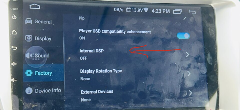

    My Android unit comes with HW:v3, SW:v2 CAN BUS Decoder.
    The sound works, but it doesn't sound like my original unit jbl. The sound is loud, but the beats aren't giving detailed bass and treble as it should no matter what i set.
    Can't find where to get the CS-Z0002 stated here, plus i tried the trick of the JBL priming with original unit by setting to vol 45 for 5secs. I felt it worked but not sure if removing car battery can reset that.
    I want to ask if there is specific Prius 2010 Android unit JBL CANBUS Decoder one can use that would output the original JBL sound.

    I finally solved the issue by going to Factory settings, inputting the password 000000 and selecting the right CarType and also turn off “internal DSP” that allowed the Android system to use the DSP equalizer settings on the unit rather than OEM sound.
