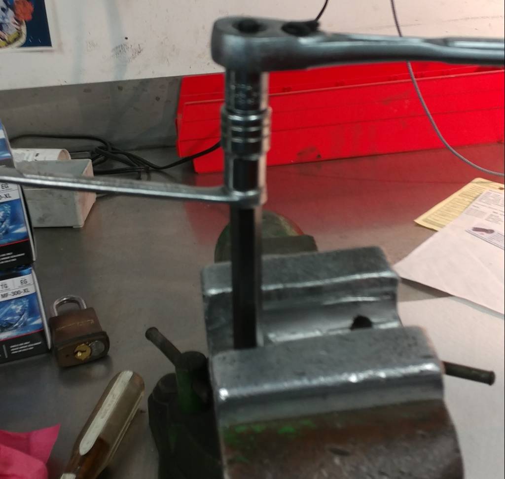

    When you said "stripped", it 1st sounded like the threads were gone, but now it sounds like you really meant rounded. Okay. Other ideas from a 3 decades Aerospace Machinist. After the rounded bolt has been thoroughly soaked with a penetrant/fluid if there's room, use a little angle grinder to make your hex a little smaller, then use the next size or 2 down socket with breaker bar. Or, what's sure-fire, is to heliarc a big as practical peace of Steel onto the top of the rounded hex - then you have a decent way to grab ahold - with an open- end wrench or whatever. Plus, a lot of time, the weld Heat will significantly help with loosening a frozen Bolt.

    It’s a rounded Allen key. What would the procedure be for that?

    Same thing. Heliarc a Allen wrench into the round out out hole & you'll be good to go. That way you'll actually be able to put 2 wrenches box, ratchet, whatever on it (one on top of the other) - turning & pulling like they're a T-handle.
    Here, just took a picture
    #44 hill, Nov 19, 2018
