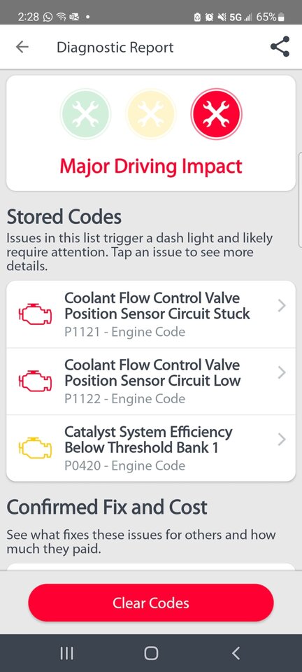

    I've gotten these error codes and my heat isn't working. The mechanic didn't do a thorough check and based on the codes just said I need a new catalytic converter. Does it make sense the heat isn't working and is it likely the only solution is a new catalytic converter?
    Obviously it's an old car and if the repair is $2k+, I'm not sure I would replace the catalytic converter. Any suggestions? TIA

    I'm thinking not so much The catalytic converters that I've bought don't have anything to do with the heat they're not connected to the water jacket it's a thing above it or whatever and that's not with the converter I don't believe now I got to go look But anyway I wouldn't think so I would think no heat I would be looking at my codes and see if you have a code for the three-way heat valve something along those lines or a non-functioning heater core for some reason stopped up whatever I can't imagine haven't seen any of this yet but I do know when the coolant control valve are the three-way valve is acting up he can be affected it very speeds if not all across the board Good luck

    The coolant flow control valve, on the other hand, can absolutely be the reason your heat doesn't work.

    Sometimes the catalytic converter error code can be due to a bad tank of gas... So clear the code after a fresh tank of gas and see if it comes back. As for the heater, that's an entirely different system/diagnosis.

    Do your coolant flow valve first to get heat and worry about the cat second.
    A genuine gen2 cat is $1400 plus shipping and tax from an online Toyota dealer.
    If you were in a non “carb” state an aftermarket Walker for $400 has worked for many.

    After going for a diagnostic at Toyota, the catalytic converter code disappeared so it seems replacing the coolant control valve should fix the issue & clear the code.
    How much is a normal cost for a Coolant Control Valve replacement?
