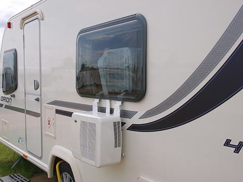

    I was hoping to do a Prius-version of RV camping with shore power. If I had a connection to mains, I'd love to be able to run the HVAC without juggling with the EV cable. The (worst) workaround would be to get a small window AC unit and slap it onto the car.

    What is this "mains" that you keep referring to ??
    Your suggestion about a window AC unit is a joke, right ? :)

    Oh how I wish the Prime has a camp mode :( I tried to workaround it by setting a departure schedule for every 30 minutes overnight. It didn't work out well.
    Mains as in electrical main line from the wall. The idea is that if I use my Prius as a super gas efficient RV camper, can I somehow hack the existing HVAC to be usable off of grid power. The consensus seems to be "no".
    I already got that lovely adapter from Rob43 that allows me to plug into the NEMA 14-50 at RV campsites to charge up the car. This is sort of a logical progression of that idea.
    As for slapping on a window AC unit to the side of the car.. I mean.. I was only half joking.
