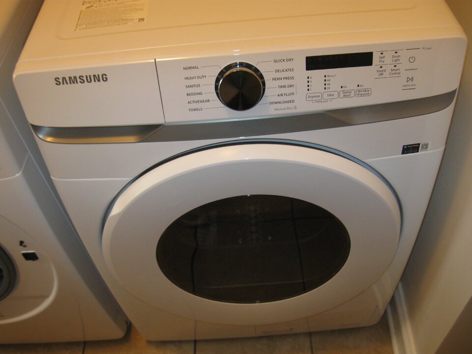

    We purchase a Samsung Ventless Heat Pump Clothes Dryer in November, and it made a big impact on our electric bill.
    One of the most overlooked features of a Ventless Heat Pump Clothes Dryer is that in the winter it is not pulling out and exhausting your homes heated air and then pulling in cool air from outside the home to replace the exhausted conditioned air -... and vice versa in the summer.
    A clothes dryer exhaust system can remove up to 200 cu ft/minute of conditioned air from the home - if the dryer runs 60 minutes that's 12,000 cu ft of conditioned air removed from you home that you have paid to condition and 12,000 cu ft of outside replacement air that had been pulled into your home that you must now pay to condition.
    It might make economic sense to investigate that if it fits your lifestyle.
    We do have a hybrid heat pump water heater and it made a tremendous difference on the energy bill and am sure your solar water heater project will do the same!
