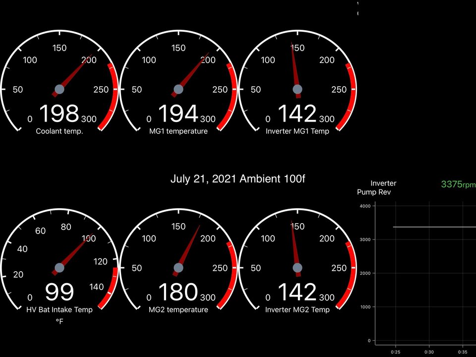

    While the transaxle uses continuously variable gear ratios and not discrete gears 1 or 2, your video sounds like the engine is rev'ing excessively high just to get to 100 kmh (62 mph).
    Recommend monitoring engine rpm, inverter pump rpm and inverter coolant temps.
    If you have a clogged catalytic converter or a severely dragging brake, the system would "gear down" to reach speed causing high engine rpms.
    Car Scanner App (typical - not showing engine rpm)
    Still no inverter coolant fluid movement? The above makes me think your inverter water pump may not be getting ground as discussed previously. Did your guy check the pump's 12v and ground at the pump's wiring connector?

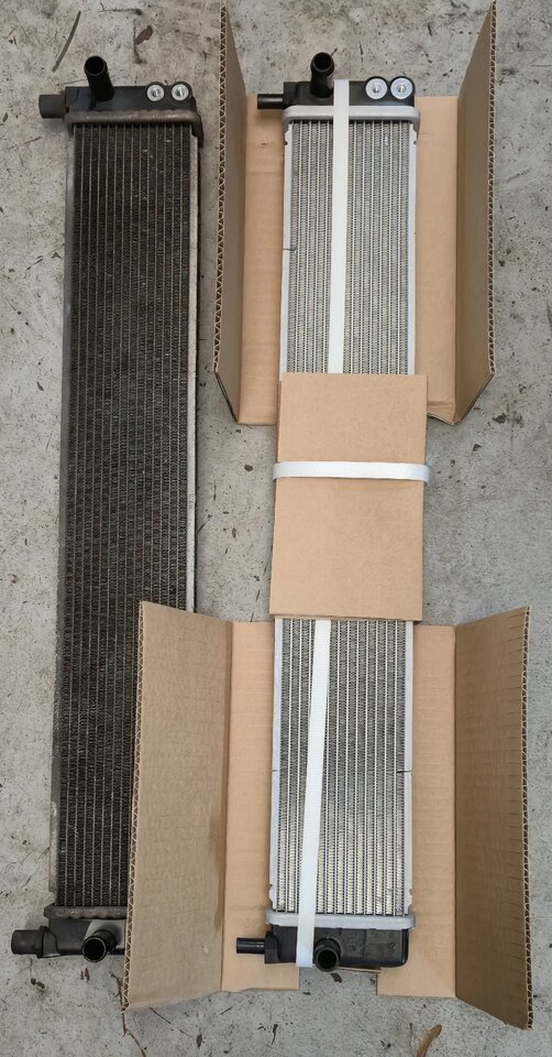

    Yes, the problem has finally been resolved. I feel that true craftsmanship is hard to find these days. I went to the dealership and saw several mechanics, but in the end, I went to another garage. There, they simply followed the coolant lines using air pressure and discovered that the coolant wasn’t circulating in the hybrid system because the hybrid radiator was completely clogged.
    The mechanic ordered a new radiator for me for €110. He charged €150 for the installation and labor. With that, the problem was completely solved.

  8. Mendel Leisk
    60,272
    41,467
    Any idea what it was clogged with?
  9. Lahmar
    Lahmar New Member
    May 16, 2025
    Rotterdam
    2013 Prius v wagon
    No, sorry,
    I honestly have no idea. For me, it was simply a matter of the radiator being clogged — replacing it with a new one and that was it. That was the quickest solution for me, and I was satisfied with it. I didn’t investigate any further.
