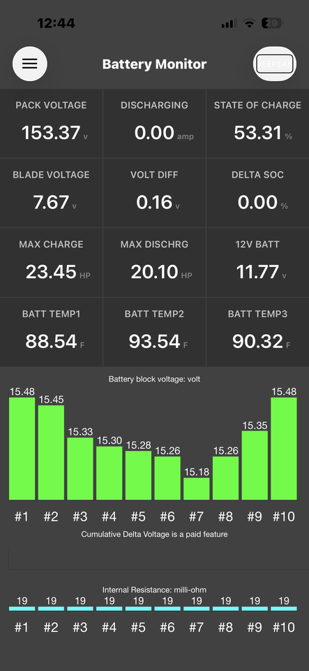

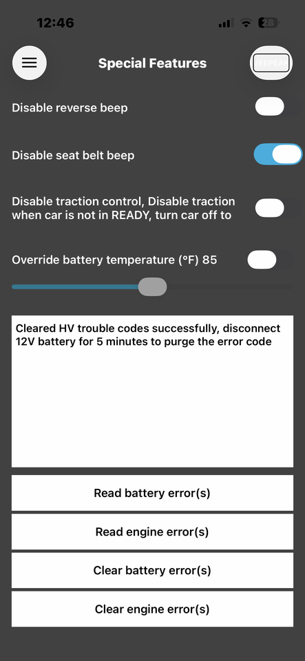

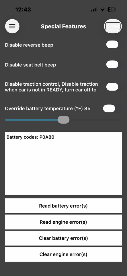

    unfortunately I’m at 110K miles and the dreaded check hybrid system message popped up on my screen. I did disconnect the 12v battery and hybrid / orange switch for 15 minutes and it did disappear however Im sure that’s just temporary. Currently everything is working fine and it seems I’m actually getting a bit better mileage.
    here’s a screenshot of the reading I did , does it look problematic ? Thanks for any help!

    Well, the hybrid batteries in the c model tend to last "about ten years" which means you're right on schedule for a replacement.
    The 12v batteries tend to go 4-6 years, so I'd think one that was new in 2024 still has a ways to go.
    The built-in diagnostics are pretty good, but they aren't perfect. I'd say there's a strong chance you do need a new hybrid battery, but you should very definitely confirm this either by taking it in to a pro, or tooling up to DIY.

    When I refer to built-in diagnostics, I'm referring to the OBD system. Even though it is crude in the sense that it just tosses up the message "Check hybrid system," it tends to be pretty darn accurate. When the root diagnostic code is found to be P0A80, it is right most of the time.
    3rd party software like Dr. Prius is pretty good for getting details about the hybrid battery, but it doesn't do much more than that.
    We (speaking for a certain group of Priuschatters) have found the Autel AP200 to be the least expensive comprehensive scanner; capable of interacting with every system on the entire car.
