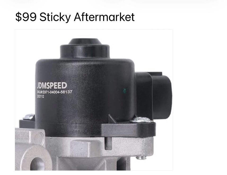

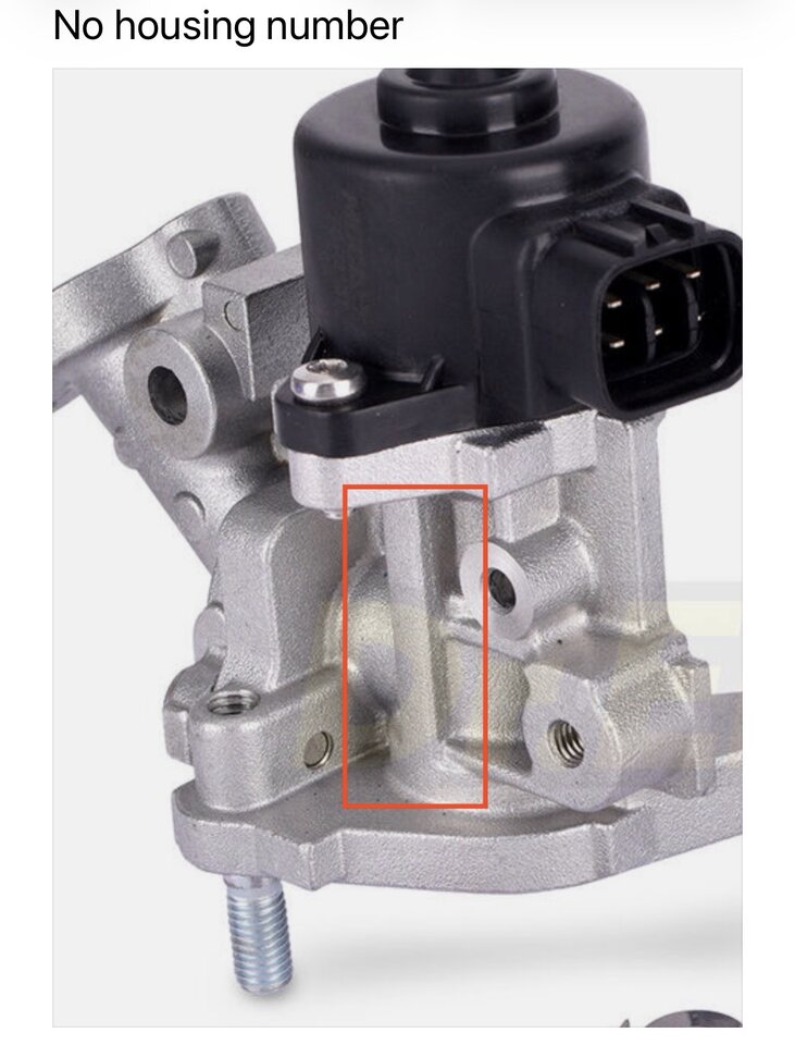

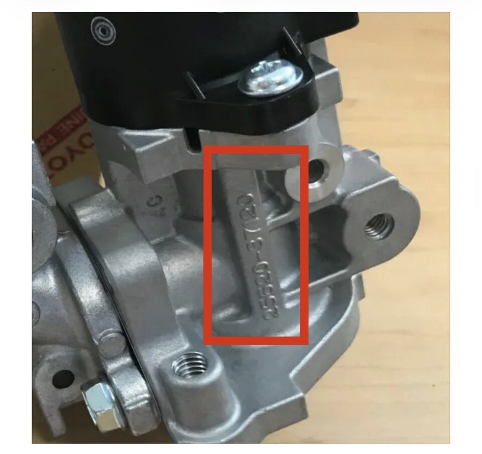

    Updated Oem egr Kit. 04004-58137 with proper housing number
    Newer EGR Valve is 25620-37120
    Egr valve updated Kit 04004-58137
    and includes 25620-37120 Updated egr valve - plus is lower cost than valve alone.

    By the way the $129 partsgeek valve is aftermarket.

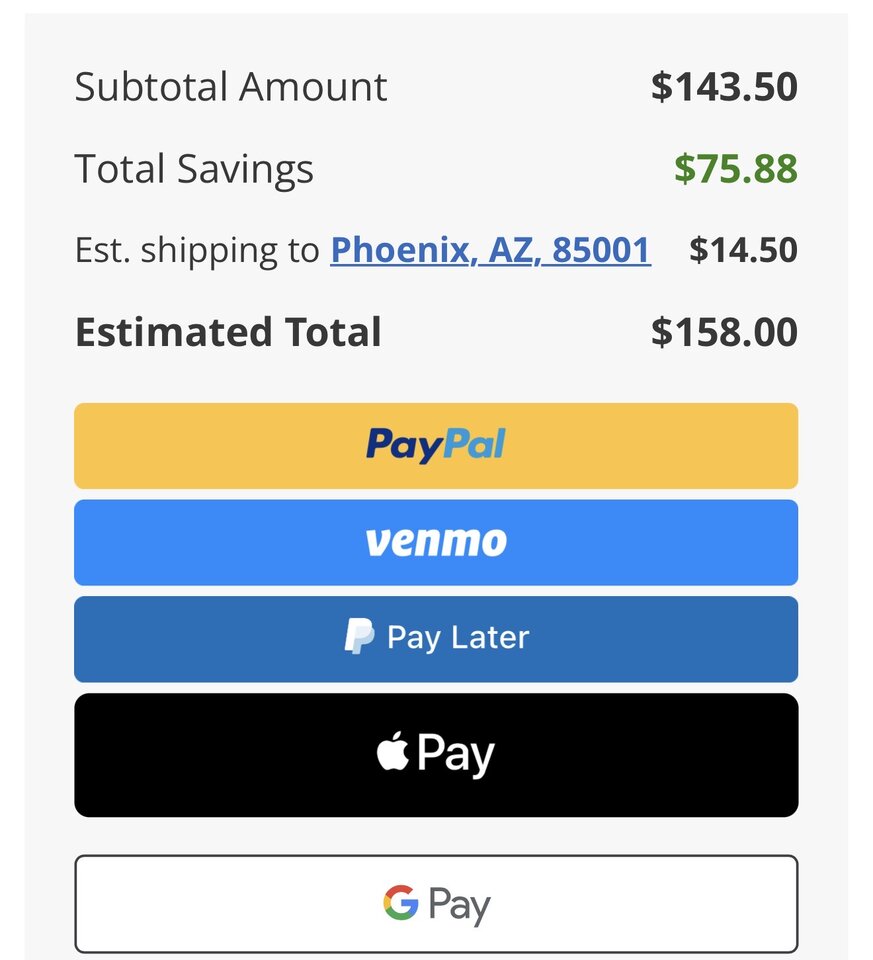

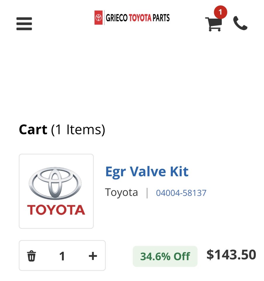

    Oem from online Toyota dealer
