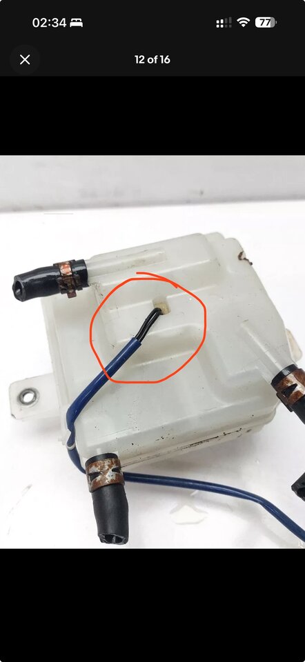

    I held my iPhone under the reservoir yesterday and watched from my Apple Watch live as I pointed it around places I couldn’t see.
    I found something bloody amazing in terms of a breakthrough. The bottom of my reservoir has exposed metal wires which show surface corrosion. They are missing the black plastic protection altogether. I have no idea how this finish could fail other than being exposed to fire level heat or being scraped off by hand. See my photos.
    I found on eBay that nearly every example of this part from way older CTs have the black protective layer in tact. This is surely why mine works - thick metal in tact capable of passing a signal when dry and then when wet or humid, causing the fault light and C1202.
    this is a new one for future owners of all these 3rd gen systems to check?
    I have emailed Lexus as I have that ‘relax warranty’. Perhaps if they agree this is a material failure they can repair it without cost to me other than their second inspection of the issue which should be easy as I have shown them these photos.
    if not… I believe from reading on here Toyota and Lexus dealers would NOT replace just this part if we asked them to and that they’d force the entire brake booster system. If that’s the case, I wonder why Toyota who replaced it last year did not replace this as well? Or… when they worked with the system why did they not notice this? If Lexus do not sort it, in fact, even if they do, I may approach the Toyota dealer and ask for an investigation. They weren’t interested when 50 weeks later this issue occurred as they said it was no longer warranted by them since my used car warranty had expired and that’s what their job was covered by in Feb 25.
    Do you know if that is a Toyota policy that this must be replaced as a full system or just a dealer choice to do so, as when they inevitably try to tell me it wasn’t needed at the time, I would like recourse to Toyota and the warranty company who were likely paying out for this piece for it to not end up in my car. Etc.

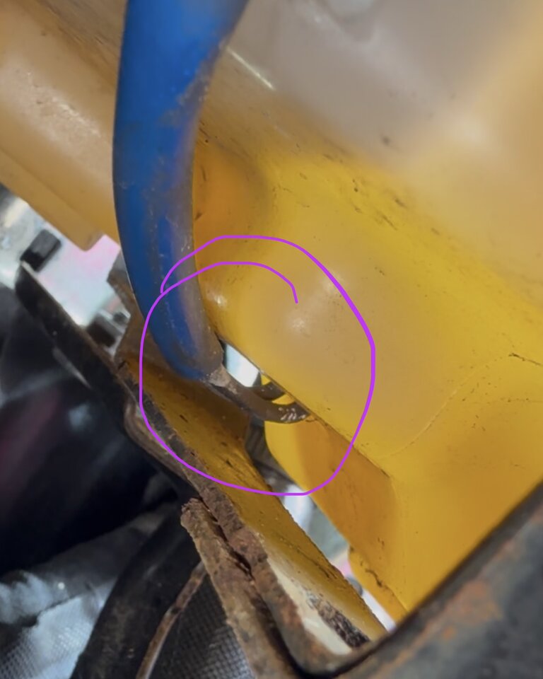

    Hello again PC forum, thought I’d keep this updated so future owners with the same electrical gremlins know what the ultimate outcome was. There were a lot of great threads on here similar to my issue, but many of them just went silent with no final outcome. Hopefully those owners got a good result, but we will never know!
    The car is at the dealership as of last Wednesday - giving them time to see the issues personally not just a photo of my codes. They were staying on constantly as per my last update.
    They discovered a rear wheel ABS sensor wire hanging on by a thread of copper, barely making contact. This was from the troubleshooting of code C1466. As I had mentioned, mid troubleshooting last Tuesday by myself, by the end up the C1202 was gone and only the C1466 was there. Perhaps this is some root fault and was leading to a coverup fault up the chain from some odd signalling being received by the skid control ECU, making the reservoir circuit appear to be broken. They have ordered and are replacing this and we hope the brake system will behave. Otherwise, further diagnostics if the C1202 comes back - or whichever code, should the four brake horsemen make their presence known on the dash. The sensor wiring makes sense as it seemingly was not so much 'only' wet or dry, or hot or cold, but humidity and then after 30 mins of driving, proper heat / dryness expanding the copper on that wire and allowing it to work for periods at a time, then boom, faults. It does line up. Covered under warranty.
    The P0010 is being covered by warranty too. Camshaft position sensor. I was worried that this was something I caused from investigating the C1202 but sensor is now ordered and will be fitted.

    It was a bad rear right ABS sensor WIRE - they said it was barely making any contact. This means the C1202 fault was a result of the inconsistent signals from the rear right ABS wheel sensor. As I mentioned, my complete brake booster assembly was replaced February 2025 at a Toyota dealership so I'd have been gutted if any big components of that system needed re-done so soon.
    They couldn't get that particular section of the loom until early June so they did a temporary repair to fix the wire in the meantime. I'll bring it back in. That was covered by Relax warranty too! That places Toyota as the #1 car brand in the world to be taking care of issues like this on an older vehicle.
