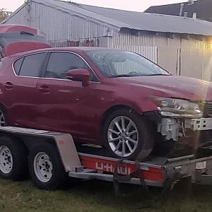

    I put it up on ramps and looked underneath the front. It appears that the crash damage is just the front bumper, the steering and suspension seem OK, the radiator is fine (but exposed), so good news there. The plastic underbody is pretty trashed. One flat tire that I filled.

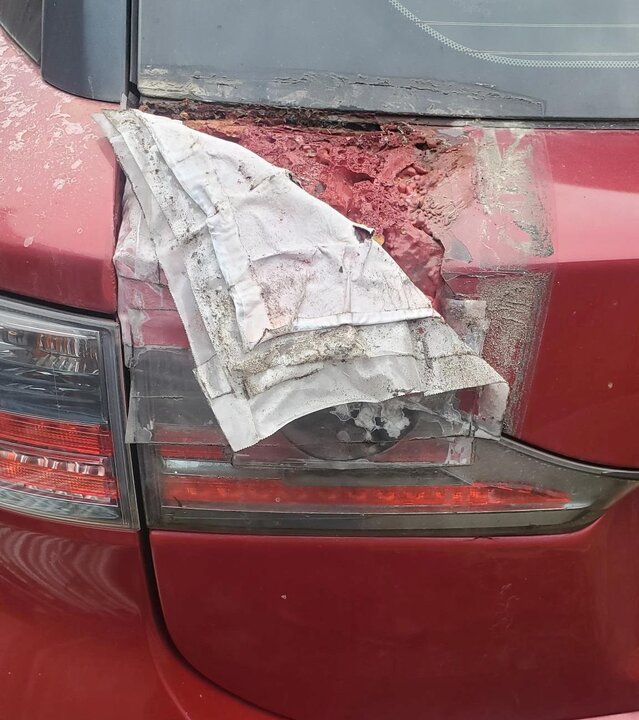

    The car was beyond gross, inside and out, so I cleaned it up a bit, and got all of the various stickers and wax pencil marks off. It has a lot of cosmetic issues that I'll just live with. The rear tailgate light apparently caught fire at some point, melted that unit and burned a hole in the tailgate, which got fixed with spray foam and packing tape...I guess I'll get some epoxy filler and finish the job. Check this out:
