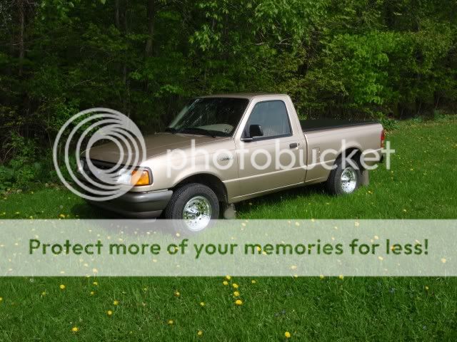

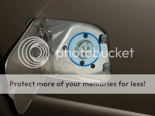

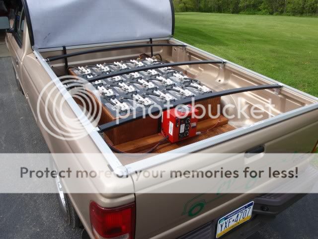

    The Ranger is a conversion, not an original. My grandson and I converted it a little over three years ago. It runs great. Of course it is just a commuter. Range is 30 miles. Speed is 55 mph.
    Jim

  14. The Electric Me
    The Electric Me Go Speed Go!
    May 22, 2009
    9,083
    5,801
    Undisclosed Location
    Neat looking finished product..
    And it sounds like it was probably an interesting project.

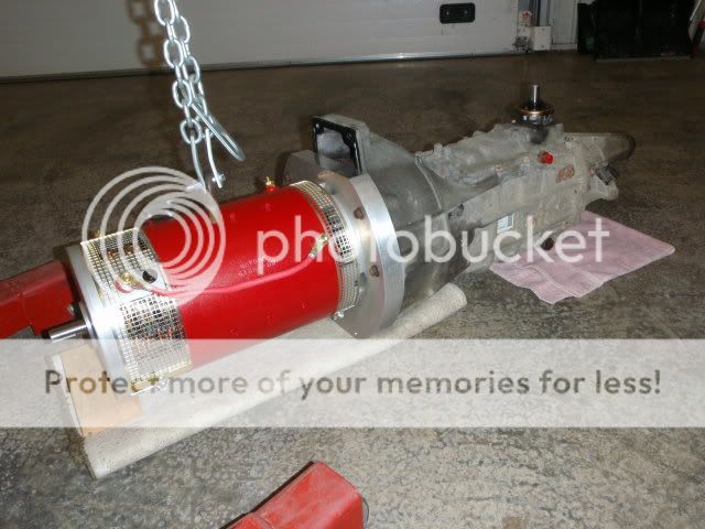

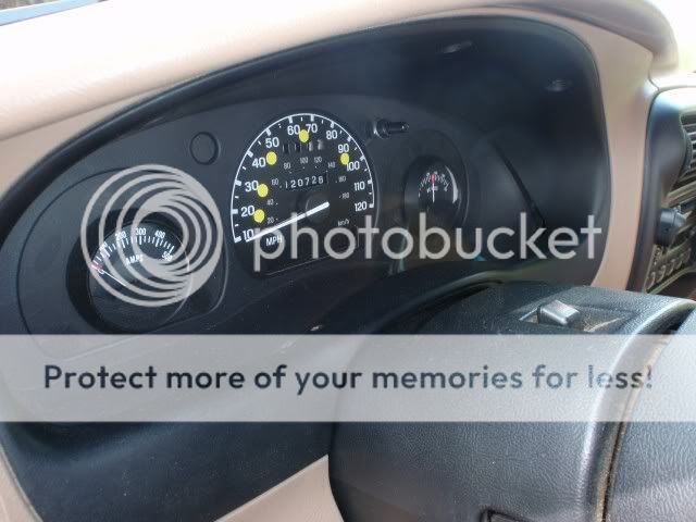

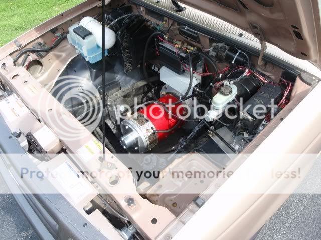

    It was not a kit. I did the project with my grandson to teach him about electrical/mechanical things so we measured, calculated and made everything.
    Here are a couple more pictures.
    Jim

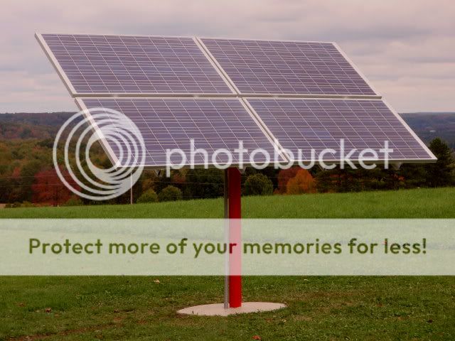

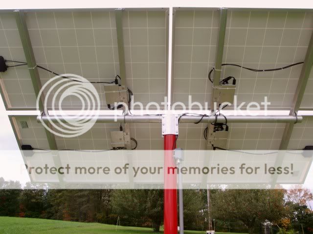

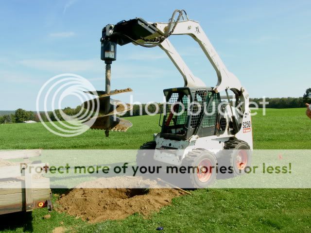

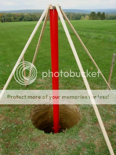

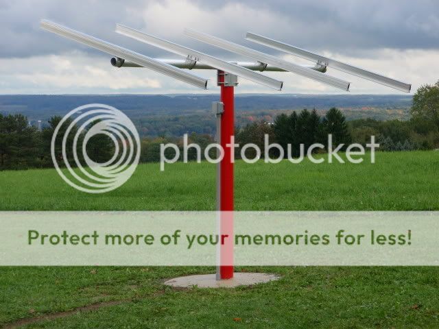

    The truck is emission free but the electricity from the grid, that we were using to charge it, was not. So we decided to install a solar system to supply "green" energy for the truck.
    Since we drive the truck during the day, when the sun is shining, we needed some way to store the electrical energy until we needed it to recharge the truck batteries during the night. A grid-tie solar system does that for us.
    For each day that we drove the truck, we were averaging 3.6 Kwh to recharge the truck. We installed four 225 watt panels, each with its own inverter, to supply this energy. Since we drive it only in good weather (we live on a dirt road), the system easily supplies all the power for the truck. The extra power just reduces our electric bill.
    Here are some pictures of the solar system.
  20. bisco
    115,223
    52,730
    very nice, that's exactly what i would like to do. my roof is too shady, but i have a field out back that would be perfect.
