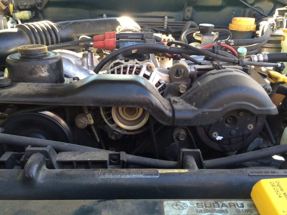

    I checked the car again, and now realize that it is not the alternator that starts and stops, but a belt fed device next to the alternator. A picture is below, showing the part. I put a white dab of paint on it for ID, and for a later video.
    Then I turned on the car, turned on a large electrical load, and took a video while monitoring the voltage at the battery. The video shows that other part cycling, and the change in battery voltage.
    So kind people -- bad alternator ?

    By this site page it seems the alternator is good. How to Troubleshoot a Subaru Outback Alternator | eHow I know it dropped below the 13.5volt limit, but I suspect you don't want non-essential loads running the test.
    The thing turning on and off is the AC compressor. Try running the test again with the AC and defroster off to make sure the voltage drop is linked to it going on. Was it just the headlights that dimmed or did the dash lights as well. Could the compressor have also come on at the time?
    When were the belts changed? One search result stated the recommended change interval was 60k miles.
    Assuming the voltage drop is linked to the compressor coming on, my guess is that it is the belt and the alternator is fine. When the AC engages it puts a sudden load onto the crank pulley driving all those accessories. Perhaps that is causing the belt to slip. Or it is completely normal behavior. The clutch for the AC is electrical, and it engaging might be the reason for voltage drop. Or the compressor is going. I noted it didn't start smoothly and skipped a little at first.
    A friend had to turn off the AC or lose power going up hill with the family's '80s Subaru. Was the hill steep enough for the car to struggle without downshifting?
    SageBrush likes this.

    Bad clutch on air conditioner compressor. Alternator is fine.
