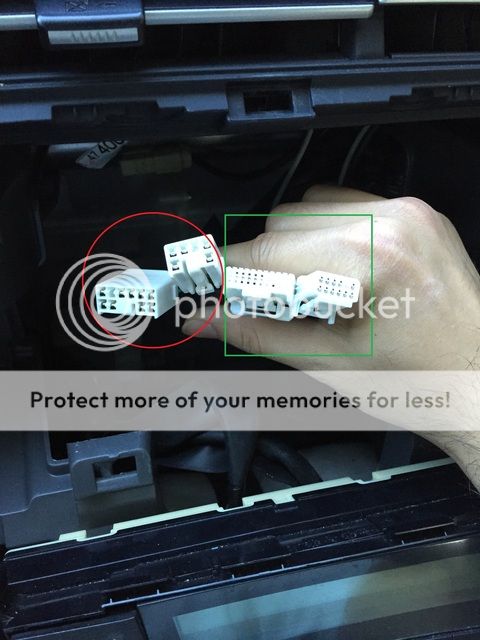

    In this pic, the red circles are for the sound which just bolt on the Android wiring harness. The green rectangles are not match with the Android harness. I don't see any one can fit them

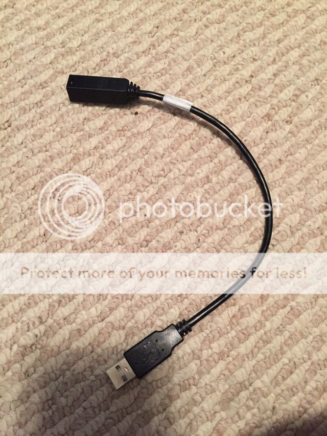

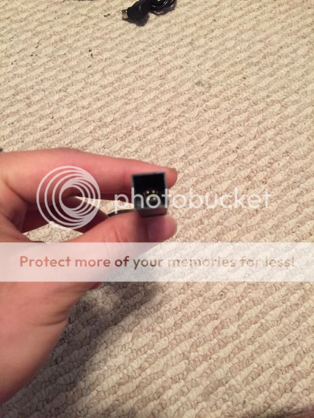

    These 2 pics are the usb cable come w/ the head unit, but I don't know what it is used for. Maybe for the Prius come w/ the usb from the factory? My prius is basic, no usb come from factory.

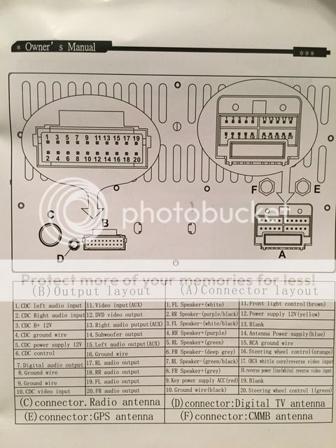

    This is the instruction, but no help :(. No D and F connection on the back.

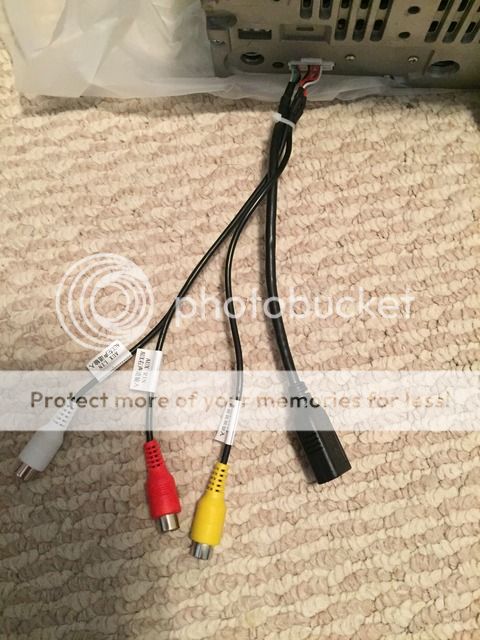

    Actual B connection. Less wires than in the instruction. They are:
    White-AUX L IN, Red- AUX R IN, Yellow-AUX CVBS, and the USB cable

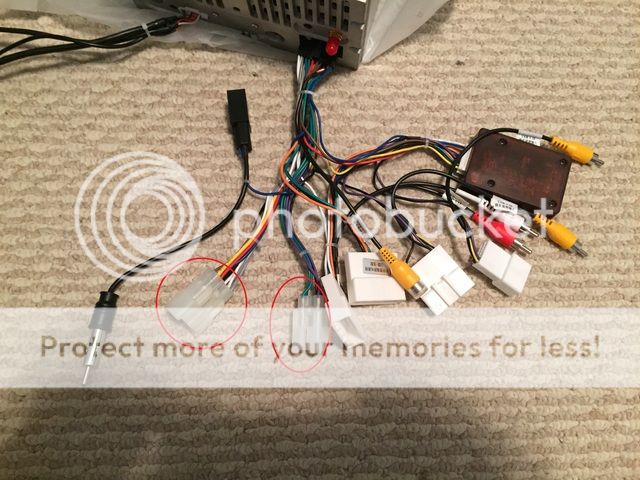

    This harness is really a mess. These red circles are known for the audio. I don't know the rest of them.
    These yellow head are all CAM V IN(exactly name printed on the labels)
    Red is AUX R IN, White is AUX L IN
    The 4 big white connector (these not in the red circles) are not match with any connector from the Prius. The rectangle red box is CAN BUS decode. There is a antena (all the way to the left in the pic), I don't know what it is used for!.
    There are too much AUX IN, CAM IN in the wiring harness. Need help Pleaseeeeeee :((
